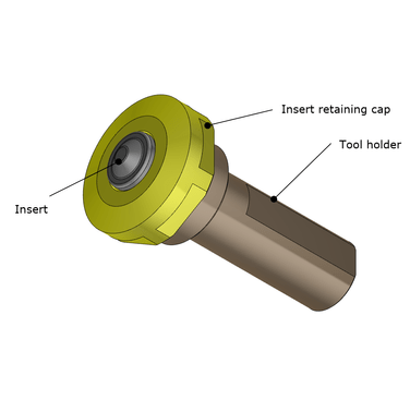

Following discussions with ceramic suppliers, it was identified that the significant cost elements in ceramic FSW tools were the bulk volume of ceramic and the finish grinding of the tool profile post firing.  To reduce bulk volume, a ceramic insert mounted in a reusable metallic holder was considered the best option.  To eliminate the final grinding operation, the insert would be machined in the green state and then fired.  The insert geometry adopted incorporated a tapered body for accurate location and flats for providing a drive feature.  The insert had a 3mm probe length.  A tool holder was designed to support and transmit the torque to the insert, as shown in Figure 1.
A weld procedure was developed for welding Ti-6Al-4V; ceramic inserts from two different suppliers were assessed making bead on plate (BoP) welds. The assessment consisted of visually inspecting the inserts then measuring their geometry using an Alicona Infinite Focus, non-contact profilometer. A two metre long BoP weld was then made, sectioned, and assessed visually by macrograph inspection and transverse tensile testing. Finally, the insert geometry was again inspected using an Alicona Infinite Focus non-contact profilometer. The pre- and post geometry inspection enabled an assessment of the amount of insert material lost during welding.
Figure 1. Model of insert and tooling system

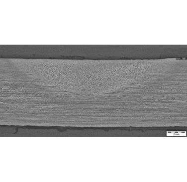

The inserts supplied by the second supplier were similar to those of the first supplier, however, the wear was much less severe.  The calculated volume loss of material from the two inserts assessed was 45.48 and 43.95mm³ respectively; an average 38% lower than the first supplier and represents 0.07% by volume of the stirred material.  It should be noted that the welding parameters used to assess the inserts from the two suppliers were slightly different, which may have contributed to the difference in the calculated volume loss.  The most significant wear was again seen in the area where the insert initially contacts the plate in the plunge phase, a little off the probe tip and shoulder areas, with less wear from the curved surface of the probe.  Distribution of ceramic particles throughout the weld was not assessed.  The strength of the welds produced was slightly overmatched to the parent plate and the welds were free from voids.

Figure 2. A macrograph of the BOP weld taken from the end of the wear assessment plate
