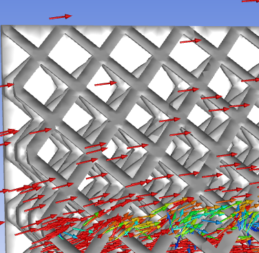

CFD analysis of an AM heat exchanger

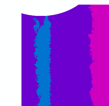

Solidification microstructure prediction for direct energy deposition
