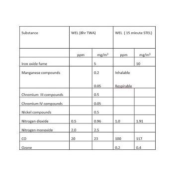

Workplace exposure limits (WELs) for the constituents of welding fume are provided in HSE Publication EH40. Generally, these limits are for exposure averaged over 8 hours, although for some components the average time is 15 minutes.  In the UK there is no WEL for total welding fume, so exposure to each constituent needs to be considered.  Welding fume is generally considered to be particulates varying in size from less than 1µm to over 20µm. Depending on the welding process, most of the particles are in the respirable fraction, which is  less than 10µm. There are also gases in welding fume which are hazardous to human health. Specifically, nitrous oxides (NOx), carbon monoxide and ozone have WELs, and new limits were introduced for carbon monoxide, nitrogen monoxide and nitrogen dioxide in 2018. New limits were also introduced for manganese compounds, see Table 1.
Of particular concern are the oxides of nickel and hexavalent chromium, which are carcinogens and manganese, which has a neurological effect similar to Parkinson’s decease.
Table 1. Workplace exposure limits in the UK for the main components of welding fume   (Ref EH40:  Third Edition 2018)
