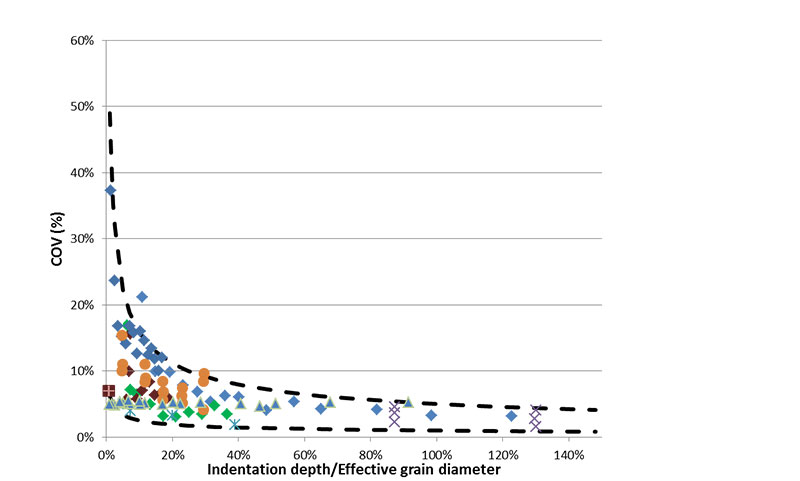

The simulations provided significant insight into the fundamental sources of uncertainty in characterising advanced material systems. Relationships between the coefficient of variation of hardness and normalised indentation depth (indentation depth to average grain size ratio) were developed as shown in Figure 3 (dashed curves).
The model predictions were then validated against over 300 different experimental measurements on multiple material systems (different-coloured data points in Figure 3).

Figure 3. COV upper and lower bound curves approach

The model predictions have provided TWI with valuable information about the limitations of depth-sensing indentation testing protocols. When the representative microstructural length-scale of a material to be characterised is known, these “look up” curves can be used to provide insight into the expected variability in measurements as well as target testing parameters than can be used to minimise variability.
