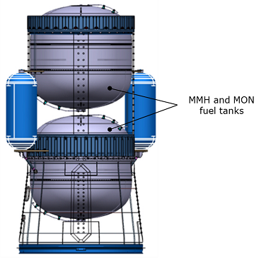

One of the solutions under development regards the connection of tabs on satellite fuel tanks by Linear Friction Welding (LFW). Airbus UK is currently working on Eurostar NEO as part of the next generation of telecommunication platforms. This platform will incorporate a new propulsion system based on a cluster of two large tanks (Figure 1) for storing MMH (Monomethyl Hydrazine) and  MON (Mixed Oxides of Nitrogen). Each tank will have a maximum volume of 1630 litres and an external diameter of approximately 1.4m.

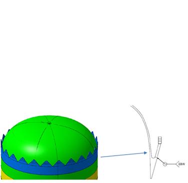

These propellant tanks are integrated in the satellite structure using an interface of tabs arranged either in a polar, equatorial or pedestal configuration, depending on the requirements. Equatorial interfaces are the most complex in term of manufacturing, as they involve machining an integral ring comprising all tabs from a solid forged billet. This ring is subsequently electron beam welded to the tank dome (Figure 2). Consequently, equatorial interfaces require a dedicated forming and welding process, in addition to those necessary for producing the tank domes and cylinders.

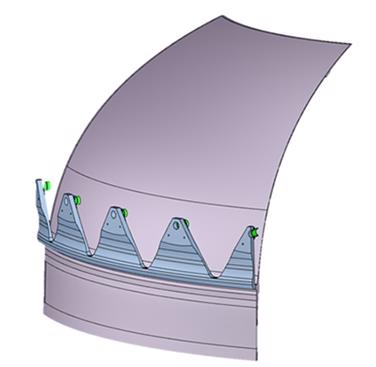

The Eurostar NEOSAT propellant tank has been proposed as a relevant case study to demonstrate this novel concept (Figure 3). This is a large tank equipped with an equatorial skirt produced via the traditional route.
Figure 1. Next Generation Eurostar NEO Telecommunication Platform (full chemical diagram, part of the service module)
Figure 2. EBW end skirt lugs to a generic satellite propellant tank
Figure 3. Tank end-skirt mounting interface used in the Eurostar NEOSAT design (dome section)

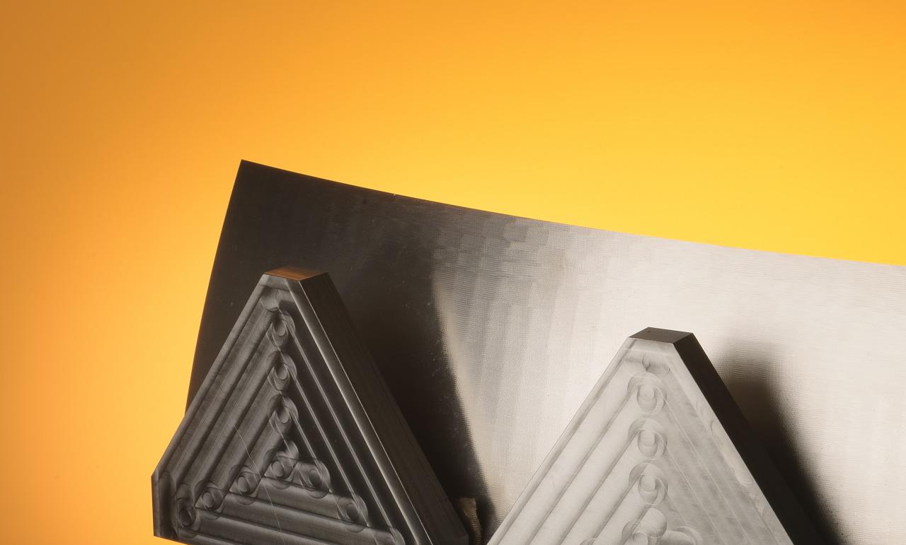

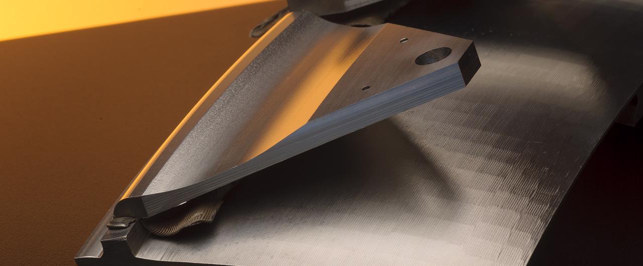

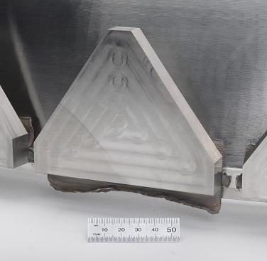

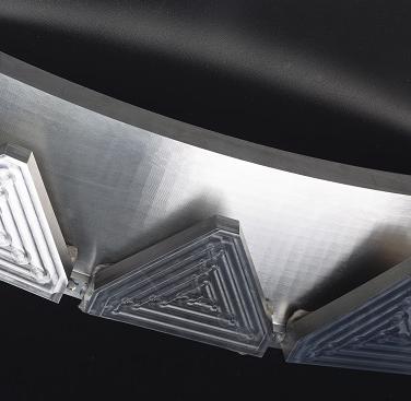

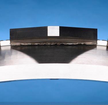

TWI has successfully produced the first technology demonstrator for this application. Three triangular tab pre-forms were joined to a representative full size section of the tank dome (Figures 4-6). Experiments proved that it is possible to prevent impingement of the weld flash onto the dome surface or the adjacent tabs. A section of the final assembly was also machined to obtain the finished tab and wall thickness of the dome.

Figure 5. Interface between dome and tab
Figure 6. Individual tab in as-welded condition
