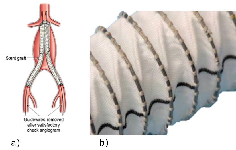

Although NiTi’s unique properties make it ideal for medical applications, they also present complications in the manufacturing of cardiovascular implants and devices. Most medical devices are currently obtained from laser-cutting of NiTi tubes, or from assemblies of NiTi elements (e.g. wires) joined at specific locations by crimping or soldering. NiTi metal stents are hand-stitched to the fabric as shown in Figure 1.

Figure 1 (a) Stent-graft; (b) NiTi wire hand-sewn to the fabric (courtesy of Vascutek and TWI Ltd)
