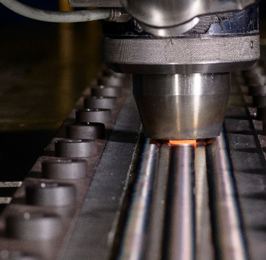

The tools, two each from multiple production batches, were tested by making 6mm penetration, bead on plate welds in 8mm thick S355 steel. Bead on plate welds were made rather than butt welds to ensure greater consistency in testing, eliminating any variables that might arise from slight variations in plate edge alignment in a butt weld configuration. The welds were performed in position control and the surface of the steel was lightly milled before welding to remove the mill scale, again to eliminate any variations in condition between the plates used. Welding was undertaken at a speed of 300mm/min using TWI’s PowerStir™ FSW machine.

A weld in progress at a speed of 300mm/min.

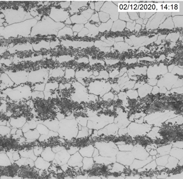

Comparison of the microstructures of the parent steel, DH36 (left) and the weld zone, (right).

Metallographic examination of the welds showed that, at the targeted 40m weld length, all the tools were capable of producing a fine grained weld with a mixed microstructure that was free from visible defects.

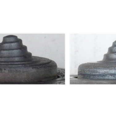

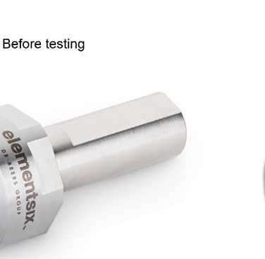

An Element Six FSW tool before (left) and after (right) accumulating a total of 60m of weld.
An Element Six tool for FSW of 6mm thick steel prior to use (left) and after completing 40m of welding (right).
