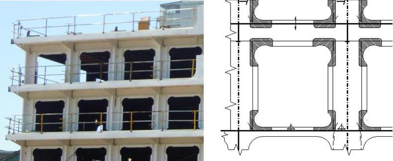

Cruise ships occasionally encounter structural problems in the corner of the balcony openings of longitudinal bulkheads on passenger accommodation decks (Figure 1), which are prone to fatigue damage. The MOSAIC (Materials on-board: steel advancement and integrated composites) project, part-funded by the European Commission, was a three-year programme that brought together organisations from across Europe to develop solutions to this issue.

The solution developed by the project team was the application of a carbon epoxy/composite patch at the corner of the bulkhead openings. This approach avoided increasing the steel plate thickness or modifying the structural geometry of the corner of the opening, which would be expensive and add weight.

Figure 1*. Balcony corner openings at a cruise ship superstructure (general view and details of reinforcement)

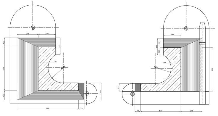

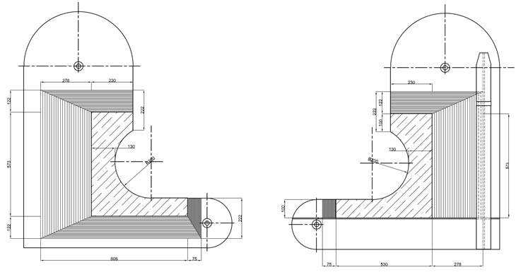

Figure 2. Technical drawing of the tested substructure with composite patches
Test specifications

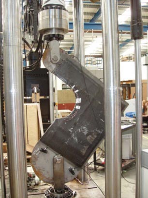

TWI designed, manufactured and tested three large-scale test specimens representative of a conventional corner opening (Figure 2). Specimens consisted of marine steel grade AH36 with two patches of carbon fibre applied on each side of the steel. Each specimen was instrumented with strain gauges and tested in air, at ambient temperature, in a servo-hydraulic test machine under constant amplitude axial loading, between -120kN and 210kN (Figure 3). This level of loading was chosen to correspond to the maximum stress levels developed in the real structure when the ship is sailing (hogging and sagging conditions). Prior to fatigue testing, the specimens were loaded under direct axial static loading in 30kN increments between maximum and minimum load.
Composite patch validated
Following fatigue testing, cracks in each of the specimens were found to have developed only in the steel plate, with no patch debonding or composite failure. The fatigue life of the patched corner opening substructure matched the behaviour of a prepared finite element model: approximately 56,000 cycles. This is twice the theoretical fatigue life obtained with BS76081, which is the code of practice for design and assessment of steel structures in the UK. In addition, the observed fatigue life from the test was found to be nine times longer than that assessed using the guidelines from Det Norske Veritas (DNV) classification society2.

Figure 3. Test setup
