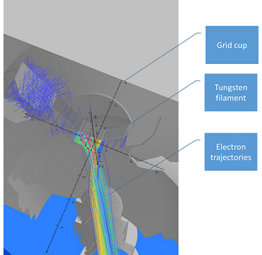

Trajectory Plot – Leaving the Cathode
In the example illustrated (Figure 1) from a 3D simulation of a triode gun with a tungsten ribbon cathode, electrons leave the cathode and their paths converge to a crossover a short distance in front of the cathode face. The convergent angle of the electrons is due to the strong curvature of the electric field introduced by the geometry of the grid cup – i.e. a small hole close to the cathode. It can also be seen that electrons leave the filament legs but remain trapped behind the grid cup.

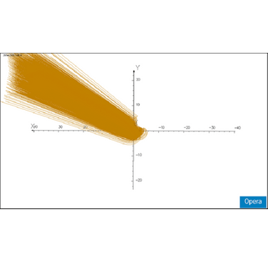

Viewing the Gun in 2D
As the gun is axi-symmetric we can also model the field and plot the electron paths in two dimensions (Figure 3). Some of the electrons accelerate to 60keV more quickly than their neighbours leaving the cathode at the same time.
