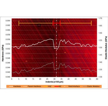

The results of the NI measurements revealed not only the boundary of the melt zone, which correlated well with the melt zone thickness measurements from transmission light microscopy (TLM) and DSC, but also the heat affected zone (HAZ) boundary, which was not visible using TLM (Figure 1).

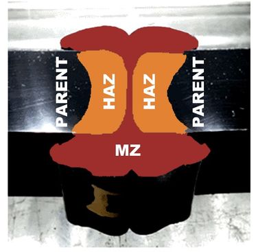

A new weld zone geometry is proposed, which consists of the melt zone bounded by the HAZ, identifiable using NI and DSC techniques (Figure 2).
Figure 1. Nanoindentation graphs of hardness and elastic modulus overlaid with TLM image of a section through the BF joint
Figure 2. Proposed melt zone and HAZ in a PE100 pipe BF weld
