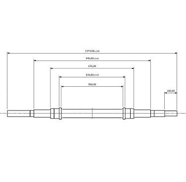

Figure 1. Technical drawing of the tested axles

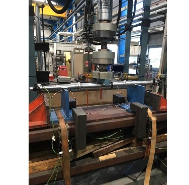

Figure 2a. Test set-up
Figure 2b. AE sensors mounted on the axle

Axles European grade 15 230.9 (Figure 1) were designed, manufactured and tested. An elliptical notch was introduced, of 3-4mm deep and 8-12mm long, simulating the shape of a fatigue crack. The equipment used for this process is electrical discharge machining.
Axles were instrumented with strain gauges and AE sensors and tested in air, at ambient temperature, in a servo-hydraulic test machine under constant amplitude loading using three-point bend testing (Figure 2).

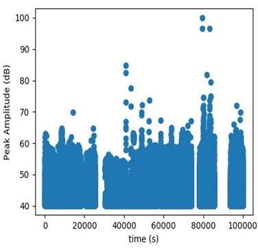

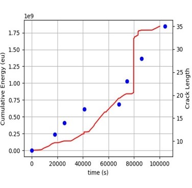

Different signal processing techniques have been assessed, taking into account noise filtering requirements and the capability of the algorithm to differentiate between damage-related signals and signals generated by other sources (Figure 3).
Both acoustic emission transient (waveform) and wave (wavestream) analysis have been considered.

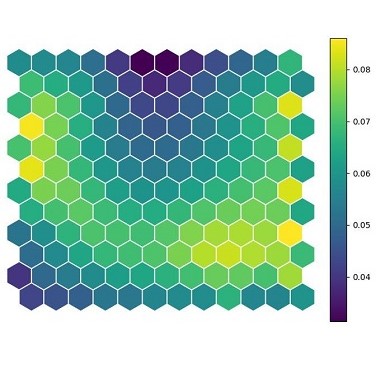

Signal processing methods investigated include established clustering methods (Figure 4) such as k-Means algorithm and Kohonen self-organising map (SOM). This technique has shown good potential for the sorting of damage AE signals from noise. Similar tests will be performed on axles grade A4T, in accordance with British railway standards. Efforts will be focused on further refining the signal processing technique applied to the upcoming tests.
Figure 3. AE raw data, (a) Amplitude vs time of hits

Figure 3. AE raw data, (b) Cumulative energy vs time with measured crack length
Figure 4. Clustering of data (a) U-matrix
