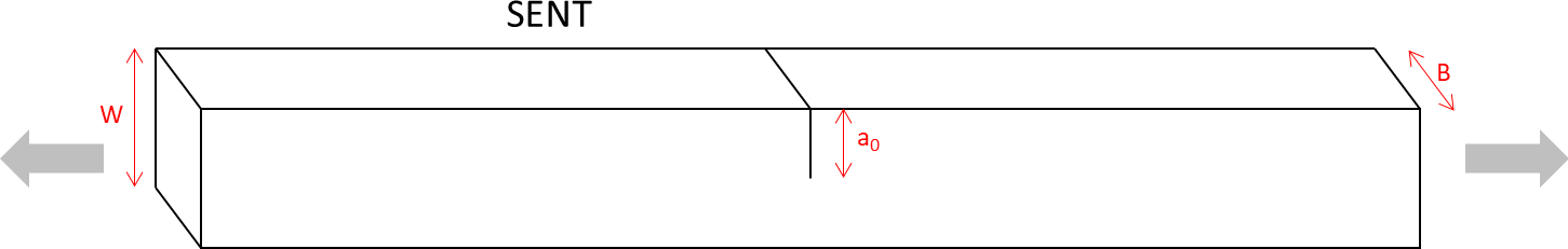

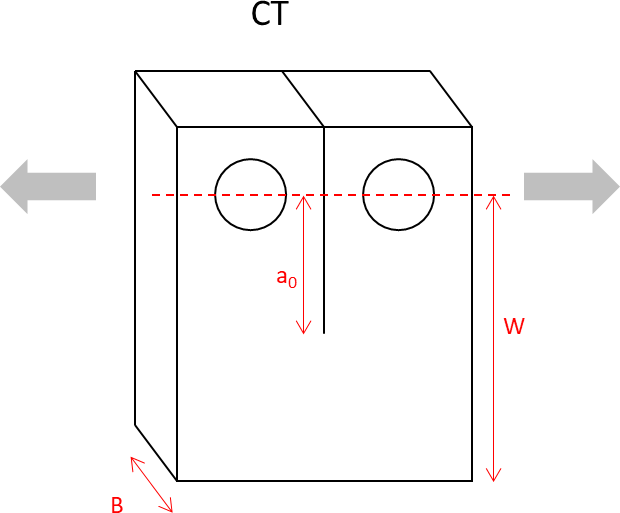

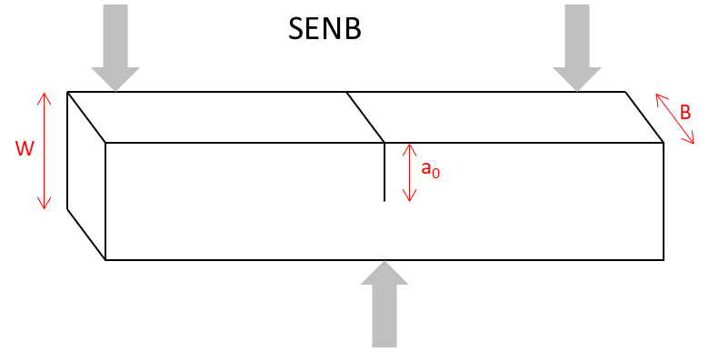

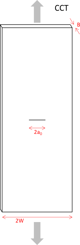

The formula for calculating depth ratio is a~0~/W, where a~0~ is the initial crack length and W is the specimen width.
0.5 is standard for single point tests, 0.55 for unloading compliance tests and for all specimen types except CCT where a/W is a range 0.25-0.4
