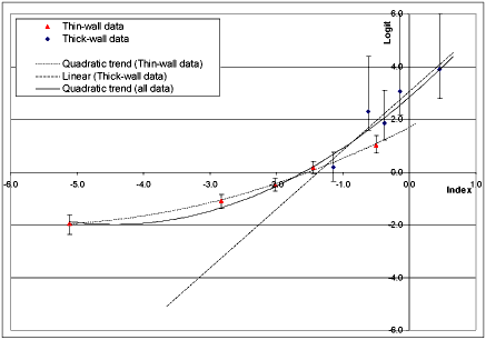

Figure 1 illustrates both sets of experimental results, together with the linear relationship (1) that was fitted to the thick-section data. Figure 1 has been produced by grouping the data according to the theoretical index I theory and plotting an estimate of the logit function given by
where
is the proportion of detections within each group. The error bars indicate approximate two-sided 80% confidence limits. Figure 1 confirms that the defects are detected with high reliability (~90%) whenever the improved Pollitt model predicts detection (i.e. I theory > 0). But, while the thick-section data in Figure 1 follows an approximately linear trend, this is clearly not the case for the thin-wall data (which encompasses a much wider range of values of the index). A quadratic trend clearly gives a better fit to the thin-wall data; this has also been confirmed by a statistical test [8] of non-linearity (at the 5% significance level).
Fig. 1. Plots of estimated logit function against index of detectability

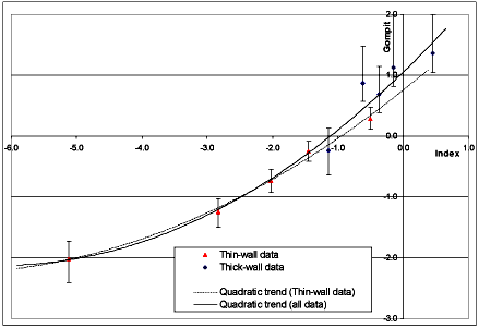

Figure 2 shows the same data as Figure 1 after transforming the vertical axis to show the 'gompit' function
in place of the logit function
. Note that we have not shown a trend line for the thick-section data in Figure 2, because the linear trend line plotted in Figure 1 (originally identified in our earlier work on thick-section welds) would no longer appear as a straight line after transforming the vertical axis from the logit function to the gompit function.
Fig. 2. Plots of estimated gompit function against index of detectability
The goodness-of-fit of the model illustrated in Figure 2 was assessed using three different statistical tests (each at the 5% significance level). All three tests confirm that the model fits the experimental data well.
