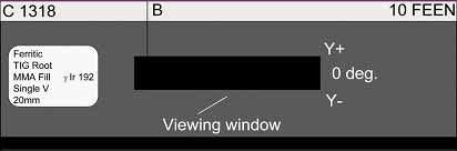

Two independent interpreters were chosen with suitable industrial qualifications (i.e. PCN level 2) and who had no involvement in any of the radiography programme.
A great deal of effort went into the mounting and masking of the radiographs ( Figure 1) in order to minimise the risk of the interpreters learning the locations of defects on the different specimens and realising that there were only 3 specimens. Further effort went into organising the order of the radiographs so that each interpreter received more challenging radiographs first in order to minimise the risk of the interpreter learning the defect locations from the easier exposures and then using this knowledge to help with the more challenging exposures.
Fig. 1. An illustration of a mounted radiograph and information supplied
