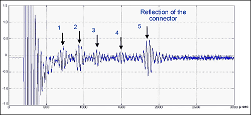

Another test piece was tested. This test piece had operational condition-generated types of flaws. The wire is identified as H26G18 with a diameter of 2.33mm. The conductive material is copper with a length of 2.55 meter. Figure 13 shows the wire sample along with its different types of visible flaws.
Fig. 13. Real aircraft faulty wire bundle
Table 1 and Figure 14 show the different reflections that have been reflected as a result of the symmetric excitation. Each reflection arrived at an approximate speed of 2670 m/s, with higher reflection amplitude from the connector. This suggests that a symmetric wave is travelling at a constant longitudinal velocity.
Table 1: List of visible fault locations
Distance (cm) Description Reflection No. Time arrival (ms) 30 Slightly burnt   224 60 Slightly burnt   449 128 Burnt & insulation brittle 1 957 148 Slightly burnt 2 1107 176 Slightly burnt 3 1316 206 Slightly burnt 4 1541 220-236 Burnt & insulation brittle 4 1645-1765 245 Slightly burnt 5 1832 255 Connector or break 5 1915
Fig. 14. A-scan results with flaw identifications
