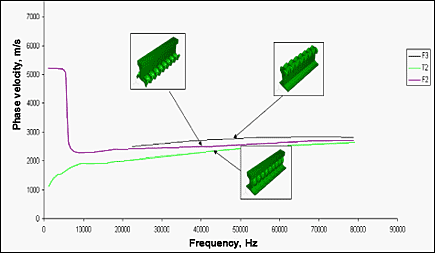

These modes have been chosen for the following reasons:
  • Each mode exists solely in one part of the rail with little expected leakage into the other parts,
  • The displacement of each mode exists in the full section thickness of the respective part of the rail, suggesting that 100% coverage of the rail cross-section may be achieved,
  • The pattern of displacement is similar for all three modes, so that similar transducer arrangements could be used for their generation and reception,
  • They are all relatively non-dispersive in the 20-80 kHz range, so that their propagation characteristics are favourable for defect detection. They also have a similar group velocities. Figure 4 shows a sub set of the dispersion curves, as presented in Figure 1, for these modes.
Fig. 4. Rail dispersion curves BS113A for selected waves
