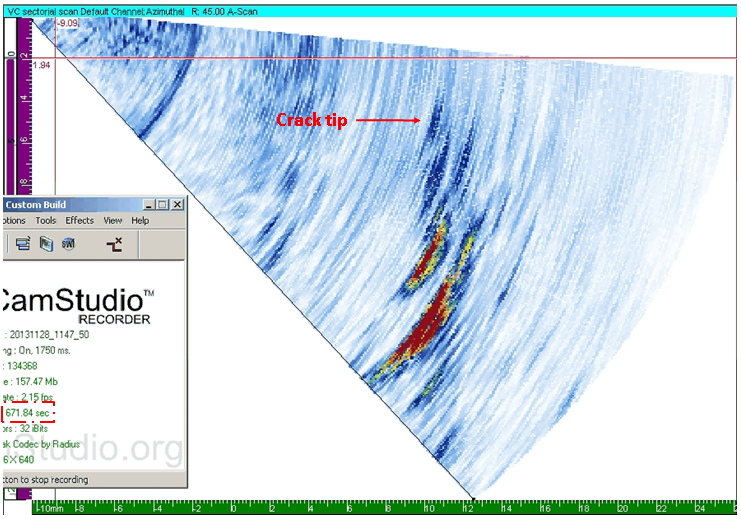

Figure 5 shows the test setup with the ultrasonic probe in position to monitor the notch and the fatigue testing machine (INSTRON). The ultrasonic data was collected using a Zetec DYNARAY array controller which was able to achieve refresh rates in excess of 20Hz. A software package called CamStudio was used to generate the video using CODECs that allow control of the frame rate and the precision of the data. CamStudio is licenced for commercial use under GNU GPL. Figure 6 shows the data collected and shows the signals from the notch corner and tip – compare to Figure 2 to understand the corresponding ultrasonic image area.

The video of the test showing the growth and failure due to a fatigue crack can be found here. The sensitivity of the ultrasonic system was set high enough to be able to detect the weak diffraction signals emanating from fatigue cracks in the pulse-echo mode – evident from the saturated signals from both the corner and tip echoes of the starter notch as shown in Figure 6. Note that the time value recorded as 0 seconds in Figure 6 was after a loading duration of approximately 7 minutes into the test, close to when the fatigue crack was initiated. The first live, measurable indication of a crack tip emanating from the starter notch was identified at a time of 129s as shown in Figure 7.

It can be seen and noted clearly on the video that the nature of the crack tip growth leads to moments in time when the crack tip cannot be seen – ie no signal is generated by the crack tip to be detected in the pulse-echo mode. For example at a time of 334s, clearly after when a crack was initiated, no indication of a tip is available in the image area – see Figure 8. The diffraction mechanism at the local crack tip level is highly dependent on the local orientation of the tip and, as the crack tip propagates, there are times when no signal will be detected. This poses a limitation on ultrasonic testing for such weak reflectors but without an exhaustive search for the tip from all different angles and all available inspection surfaces (which in practice will take a long time and be an expensive effort), this limitation must be accepted and factored into any testing and monitoring regimes. Figure 9 shows the presence of a typical crack visible on the edge of the specimen, ahead of the notch tip; the actual crack depth at the centre of the specimen at this point in time was closer to the failure point, illustrating the usefulness of the method using ultrasonics which is able to interrogate inside materials.

Figure 13 Last measureable position of crack tip at 672s before final failure.
