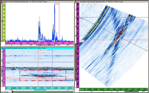

The through-wall depths of the cracking could be confidently measured in the skewed beam scans using diffracted signals from the tips once their through-wall height exceeded approximately 6mm.
As the cyclic loading continued it was clear that the majority of the damage took place within three adjacent threads. As the cracks grew towards the outside surface of the component, the un-skewed beam scans were utilised to monitor the cracks. Figure 11 shows the direct but very weak diffracted echo detection of the tip of a fatigue crack using un-skewed beams late in the fatigue life of the component, close to final failure. Figure 12 shows the corner echo generated between the outside surface of the component and the fully through-wall crack which led to the final failure of the component.
Figure 11 - The weak tip diffraction echo from a fatigue crack using un-skewed beams; note also the existence of several regions of major cracking

The performance of the phased array inspection system was evaluated both during and after the fatigue test. During the fatigue test, the phased array technique was run parallel to a previously trialled conventional ultrasonic inspection procedure based on the P-scan system. This allowed a level of cross-checking between the two systems. Figure 13 for example shows the detection of the onset of cracking damage using the conventional system, corresponding to the data presented in Figure 9 from the phased array system. Unlike the phased array system, the conventional ultrasonic system was unable to provide crack growth information and was relatively more difficult to discriminate actual damage in the early stages in comparison to the background noise – as between Figures 9 and 13.
Figure 13 - Detection of early damage adjacent to one of the keyways using the conventional ultrasonic system, corresponding to the data in Figure 9, highlighted in the dotted red box
Post-failure of the component a comprehensive failure investigation was carried out on the component to establish the mode of failure and verify findings of the monitoring inspections done during the fatigue test. The post-failure investigation included further inspections using magnetic particle inspection (MPI), eddy current testing (ECT), alternating current potential difference (ACPD) and visual analysis of sections through the threading.
The phased array ultrasonic technique was found to be effective in mapping the distribution of cracking, able to detect cracks of 3-4mm in extent. There were however errors in positioning cracks to the correct threads, with several distinctly different cracks being classed as one and cases where one real crack being reported as distinctly separate emanating from different threads, as discriminating the signals were exacerbated by the majority of damage being confined to three threads. An additional limitation was the masking of smaller cracks behind larger ones as the sound could not penetrate the larger one. These effects are illustrated in Figure 14 which shows two cracks from two separate threads.

Where the weak tip diffraction signals from the cracks were detected (as shown in Figure 11) and where they were compared to sectioning data close to the corresponding circumferential section from datum, the through-wall sizing error between the phased array system compared to MPI/ACPD/sectioning ranged from 1 to 12mm. This error will depend on the local crack tip conditions with respect to the incident beam. As can be seen in Figure 14, the trajectory of the cracks change significantly as they propagate and the likelihood of their relative orientation to the incident beam being favourable for generation of sufficiently strong diffraction echoes is difficult to predict. If, as for the positioning of the cracks above, it was possible for significant movement of the probe on the outside surface of the component then the techniques can be designed to maximise this likelihood.
