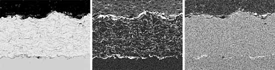

Elemental chemical mapping of the as-deposited, unsealed arc (Fig.7a) and inert gas shrouded arc sprayed (Fig.7b) NiCrTi coatings post exposure revealed significant oxidation of the NiCrTi coating and the presence of chlorine species at the substrate-coating interface. Calcium and phosphorous were present on the surface, reflecting ash build up, along with other species including sulphur, silicon, and potassium.
a) as-deposited arc sprayed and
b) inert gas shrouded arc sprayed NiCrTi coatings subjected to 1780hours exposure in a dedicated biomass plant. Nominal coating thickness, 300µm
Fig. 7. Elemental mapping showing presence of oxygen (middle) and chlorine (right) in

Element mapping of the as-deposited, unsealed Cr3C2-NiCr suggested that significant oxidation of the coating surface and substrate-coating interface had occurred. Chlorine was also present at the substrate-coating interface and was more evident penetrating into the substrate material. Calcium and phosphorous were present on the surface from ash build up, along with other species including sulphur, silicon, and potassium.
