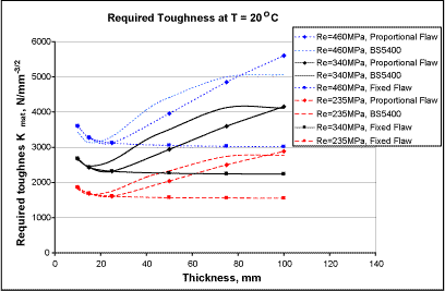

Fig.1. Results from fracture mechanics analyses for proportional and fixed flaws, and a comparison with BS 5400 requirements

The results of the analyses are shown in Fig.1 to 9.
The required toughness (K mat ) for the three materials and the two types of flaw (proportional and fixed) is shown against thickness in Fig.1. The figure refers to the requirements at T min =20°C, but the results for T min =-50°C were virtually coincident, assuming the value of K mat to be that associated with the temperature T min . The equivalent curves used to derive the BS5400: Part 3 rules are also shown for comparison with the results of the current study. It can be seen that, for the geometries and flaw sizes investigated in the present work, the required toughness actually decreases slightly with increasing section thickness from 10 to 25 mm. This is simply because BS7910 [8] uses two failure criteria: brittle fracture and plastic collapse of the uncracked ligament. For these thinner sections, plastic collapse tends to dominate, and the toughness requirement therefore initially decreases with thickness. As thickness increases beyond 25mm, fracture becomes the dominant failure mode.
The calculated minimum material fracture toughness values were then correlated with a required value of T 27J , using the Master Curve correlation. Since the Master Curve is based on K mat values measured on a 25mm thick specimen, a correction is required to account for thickness effects. The Master Curve thickness correction is based on a 'weakest link' theory, i.e. the larger the specimen tested, the greater the likelihood of the flaw sampling an area of low toughness. Consequently, components of thickness greater than 25mm require increased fracture toughness (and hence decreased T 27J ) compared with 25mm thick components. Conversely, components less than 25mm thick would be expected to require less toughness (and hence increased T 27J ) compared with 25mm thick components. The precise shape of the T 27J vs thickness curve is then dependent upon both how the calculated values of K mat vary with thickness and the Master Curve thickness correction.
Figure 2 shows the minimum Charpy requirements (in terms of a specified value of temperature difference between T min and T 27J ) for the avoidance of post-weld heat treatment as a function of thickness, t max , for the case of initial flaw sizes assumed to be proportional to the thickness. Figure 3 shows the equivalent requirements assuming a fixed flaw height of 3mm. In the case of the fixed flaw size, the toughness requirement levels off for thickness above 70mm, whilst for the proportional flaw, the required material toughness increases with section thickness.
The required material fracture toughness at the design minimum temperature increases with material strength. Figures 2 and 3 show that for both proportional and fixed flaw size cases, the curves for different strength levels (R e =235 and 340MPa) lie approximately parallel to one another, with higher toughness requirements (larger value of T min - T 27J ) for higher strength steels. They also show that higher toughness levels are required for a lower probability factor in the Charpy energy absorption/fracture toughness correlation, and that higher Charpy energy requirements apply to the 'proportional flaw' than to the 'fixed flaw'.

As noted earlier, the required fracture toughness (K mat values) for a thick-section welded joint made from high-strength steel was found to approach 5,500N/mm 3/2 (173.8MPa √m) at the minimum operating temperature. This requirement may be somewhat difficult to satisfy in the weld and heat-affected zones of many structural steels without very careful control of welding consumables and welding procedures, particularly as fracture toughness is generally observed to decrease with both section thickness and material strength.
As material yield strength increases, not only do specified toughness levels commonly increase, but it becomes increasingly difficult to meet toughness requirements without a PWHT, as noted earlier. For example, for steel C (R e =460MPa) 25mm thick, intended for service at -50°C in the as-welded condition, the results of the fracture mechanics model calculations show that, for a failure probability P f = 0.05, T 27J = -89°C is needed. This would probably be impossible to achieve in a parent and HAZ of a C-Mn steel of this strength. It may be noted that, for the example given, the PD 5500 [26] toughness requirement would be 40J at -176°C (T 27J ≈-185°C), while the API 620 [19] requirement would be 40J at -67°C (T 27J ≈-76°C). Thus, whilst the requirements of the codes have generally been found to be conservative, the degree of conservatism clearly varies, and may not always be present for the higher strength grades of steel. For fine-grained C-Mn steels of this strength level that are intended for service at low temperatures, it may be therefore be appropriate to carry out a fracture mechanics analysis to see whether PWHT can be safely omitted.
