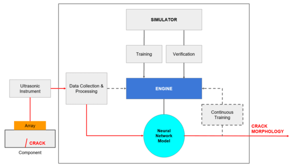

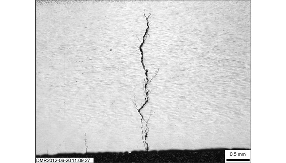

The presentation will investigate the detection of surface breaking cracks such as stress corrosion cracks and thermal fatigue cracking occurring in nuclear power plants. These faults are easy to spot if the surfaces can be inspected with visual and dye penetrant testing techniques, but more challenging if the affected surfaces cannot be accessed, such as when they occur inside pipes and vessels. In these instances, ultrasonic testing can be an effective solution. However, ultrasonic tests generate large quantities of data that can take a long time and be costly to analyse, as well as having quality issues in relation to personnel training, competence and fatigue.
Machine learning (ML) has the ability to overcome these challenges and this talk will detail the capabilities and limitations of ML techniques for ultrasonic inspection, including a case study to demonstrate strategies to validate and qualify them as a component of ultrasonic inspection systems and procedures, following guidance in ENIQ RP 13.
