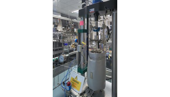

The equipment was originally built to assess the resistance of corrosion resistant alloys to sulphide stress cracking in high-chloride solutions; however it can be used to test a range of different materials in various operating environments.

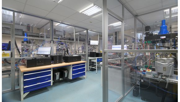

The laboratory includes five servo-electric load frames (40kN) with Hastelloy C276 vessels rated to 350 Bar; digital mass flow controllers on the inlets to each vessel; uninterruptable power supplies attached to each booth; and steam condensers on vessel outlets.
The new lab is capable of running a range of HPHT environmental tests, including slow strain rate tensile testing (including long cross-weld specimens); C(T) fracture toughness testing with DCPD; corrosion-fatigue (FCGR) testing; KiEAC tests, and more.
