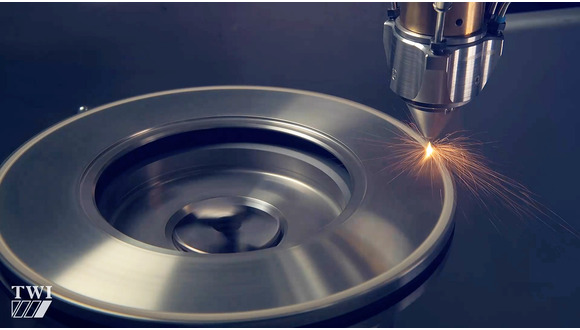

The EHLA process is chosen for the coating of the brake discs because: 1) it can provide a stronger metallic bonding compared to thermal spray coating processes, 2) EHLA can provide greater economics via a high coverage rate (up to 5m2/hr) , high material efficiency (up to 90% in-process) and minimised coating thickness (down to 20µm) , 3) multi-material and dis-similar materials can be deposited using EHLA due the low dilution (as low as 5µm). An early demonstration of coated disc (ø =434 mm) is shown below with a coating thickness of 50 μm with 35 seconds processing time/side.
Fig 2. Demonstration of coated disc
