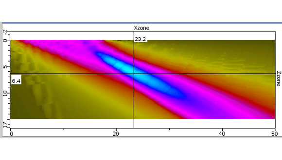

TWI started the project by undertaking a simulation study to define the diameter and refracted angle of the single element transducers for the nonlinear ultrasonic testing (NLUT) hardware. The aim was to ensure a good beam profile for both the transmit and receive probe, with a -3dB focal zone at the depth of interest. The modelling results were used to aid Vermon in the design and manufacture of the transducers for integration into the KiScan system.

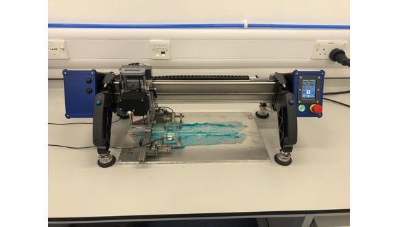

Our main role in the project was testing KiScan’s performance in an operational environment.  A prototype scanner was constructed at TWI North in Middlesbrough in order to define the optimum inspection parameters, including the data acquisition process and signal processing algorithms. The system was then transported to our FSW facilities at Sheffield for performance testing, which was successful, gaining positive initial results. From the results, a performance assessment was conducted with modifications proposed to improve the system.

We have recently received the finalised KiScan scanner from I KNOW-HOW. We are in the process of conducting final trials with the scanner before the certification process commences. The new state-of-the-art scanner and software implementation will improve the KiScan system and generate improved results for the detection of kissing bonds in FSW materials.

Figure 1.  KiScan Scanner

Figure 2. CIVA modelling - 2.25MHz transmitter
