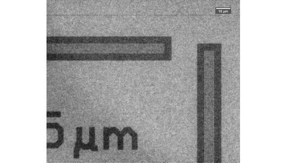

The X-ray system has been able to achieve a spatial resolution of 0.5 µm, enabling detection of sub-micron defects within the inspected samples. See image below.
