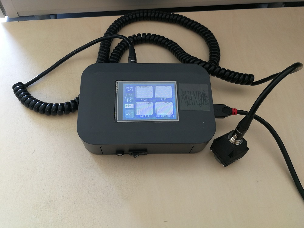

The VANDA system is a train door health inspection and monitoring system that utilises vibration analysis to assess the condition of train doors.
The methodology is based on capturing a vibration profile or signature, emitted by any piece of mechanical equipment in motion.  The signature reflects its operating, or specific health, condition at a certain point in time.  It is considered that the mechanism would either continue its operation in the same health condition, or have noticeable degradation when compared to its signature.
System description

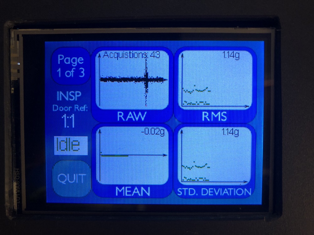

The main features of the VANDA system include:
  • User friendly controls and touch screen
  • Compatibility with different sensors, i.e., 325, 326, 354, 1001, 1002
  • Sampling rate of 4000 data points per second
  • Parameter setting interface
  • Manually set measuring duration
  • Recorded vibration data display
  • Signal processing capabilities, i.e., relevant features of the vibration signal, allowing time-domain and frequency-domain analysis
  • Recorded data and results streamed to computer for post analysis

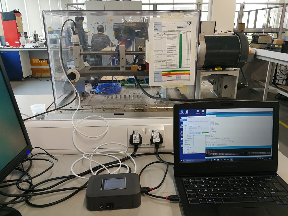

An experimental rotating rig was setup in TWI’s laboratory and used to test the sensitivity of VANDA to changes in the vibration of the mechanism.  During the algorithm validation process, the DEWESoft commercial system was used, proving that different levels of vibration can be distinguished.
Figure 1. VANDA screen
Figure 2. VANDA system
Figure 3. Experimental setup in TWI's laboratory

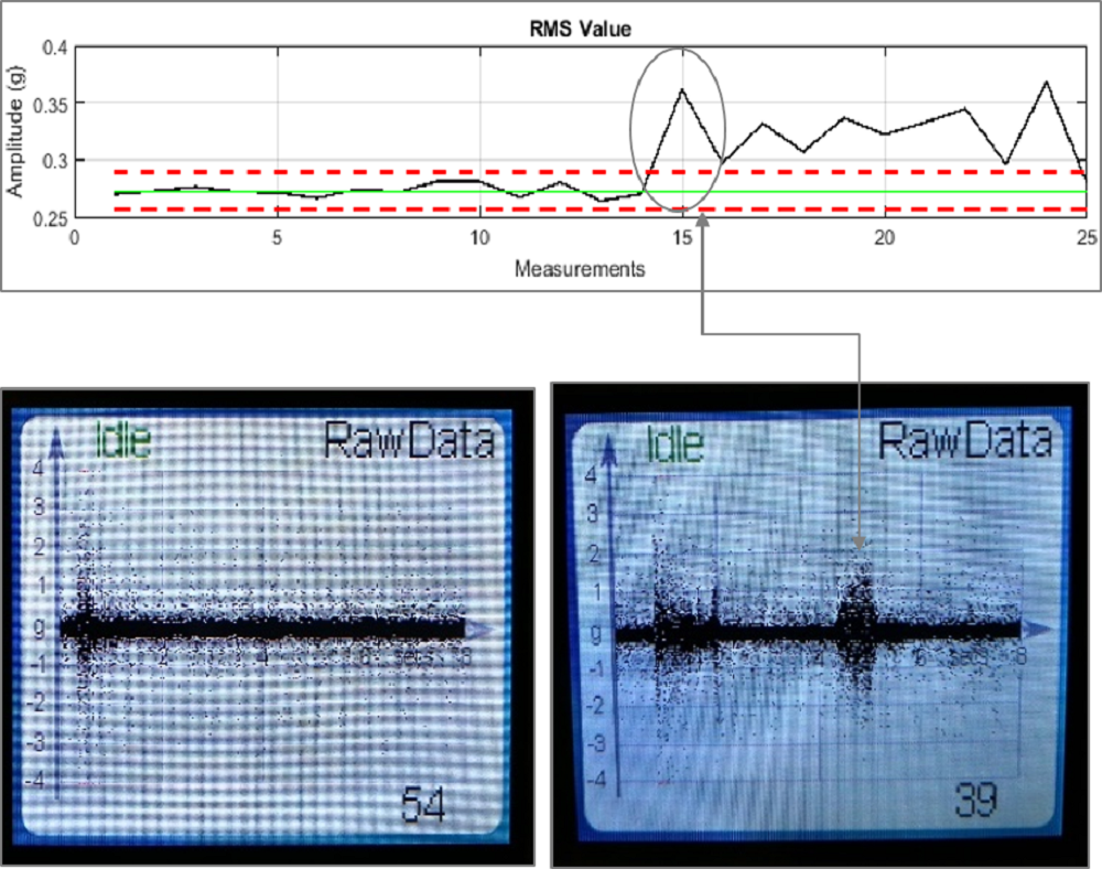

The parameters used for differentiating between the two states, as well as opening and closing, were the RMS Amplitude, the Crest Factor and the Euclidean Distance, such that:
  • The RMS Amplitude is defined as the variance of the signal magnitude, being an indication of the amount of vibration energy
  • The Euclidean Distance is used for quantifying all significant deviations from the vibrational spectra of a healthy door mechanism, during the opening and/or closing states
  • The Crest Factor is often used as a measure of discrete impulses which are larger in amplitude than the background signal but which do not occur frequently enough to increase the RMS level of the signal.
The vibration was higher in certain areas of the door and, therefore, easier to detect from different locations of the accelerometers.  It was observed whilst processing the acceleration signals that some parameters were more relevant than others, depending on the type of the damage.  Furthermore, the trials showed that some of the damage created higher vibration levels in the closing case of the door, and were more difficult to detect in the opening case.
The VANDA system was able to identify deviations from the baseline for all induced defects, with results comparative to commercially available systems.
Figure 4. Defect identification – data processing: comparison between baseline and signals after the defect was induced. Top: RMS Amplitude for baseline (first 15 measurements) and unhealthy state of the door (last 10 measurements). Left: Baseline raw data. Right: Raw data after the defect was induced in the door mechanism.

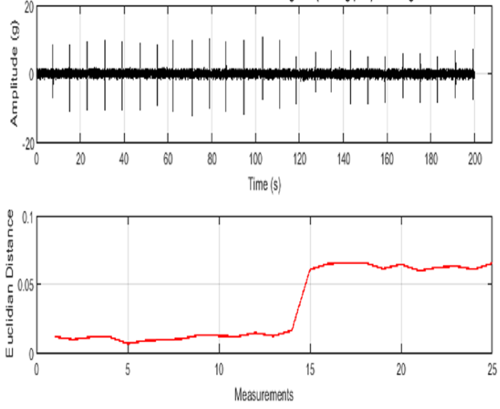

Figure 5. Raw data from baseline signals (first 15 measurements) and signals gathered after inducing a defect in the door mechanism (measurements 16-25). Euclidean Distance used as the parameter in signal processing, showing the change in vibration signature.
