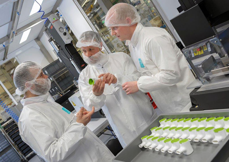

As many of the nebulizer’s individual component parts have a technically challenging complex curvature, the team carried out a feasibility study to assess the best method for joining. TWI identified ultrasonic welding as the most appropriate method as it produces high quality joints rapidly in a range of materials and joint configurations. It is a relatively mature process which is commercially accessible, meaning development and production costs should be lower.
TWI assisted with the design and manufacture of the aluminium sonotrodes and nests - components that are responsible for introducing the workpiece to the 20kHz ultrasound energy. TWI also validated the welding process for two different thermoplastic material types (Grilamid TR90 and Noryl HN731A) on the four weld joints, with ultrasonic welding trials conducted on 100 pairs of each material supplied by Philips Avent, using a range of machine settings.
On completion of these trials, the team assessed a number of the welds by manual testing and visual inspection, and found that the robustness of the device was acceptable. TWI provided a summary of the work, which included the feasibility of ultrasonic welding each joint, and suggestions for process improvements.
