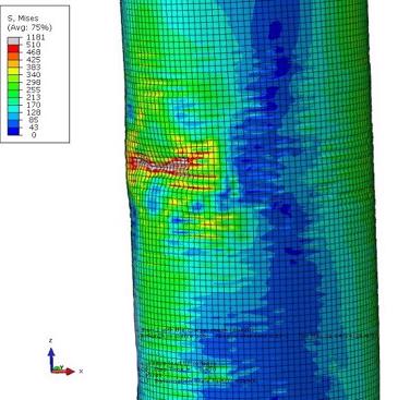

The software combined risk-based inspection, total quality inspection, fitness-for-service, and optimum repair technologies data. TWI’s decades of NDT research experience and knowledge of inspection procedures was coupled with BS 7910 and API 579 assessment expertise to ensure the software was both adaptable and in line with current standards.
TWI also used expertise in weld repair, cladding, surfacing, and coatings to help advise on remediation techniques including replacement, modification or material upgrade.
Outcomes
The outcome of the Horizon 2020-funded project is a system that uses a conservative area calculation and corrosion rate estimate to produce a remaining life evaluation for each conductor. From here, a fitness-for-service approach can be selected for each conductor depending on global bending, compressive loading, or a combination of the two. This assessment is backed up by a stability check, which is in accordance with international standards.
Once the assessment is complete, the operator can use ASPIRE to determine risk targets based around the probability and consequence of failure and a recommended time until inspection is required.
