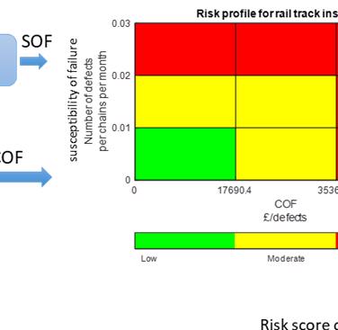

  • The software develops risk profiles of track segments, where ‘risk’ is a combination of susceptibility to failure (SoF) and the consequence of failure (CoF)
  • SoF is determined using AI/machine learning techniques on databases that include maintenance data, geographical information, weather data and population density
  • CoF is currently determined using Network Rail’s MAC code but can be customised to end-user requirements
  • The risk profile of the track system comprising track segments is shown on a user-friendly risk matrix (see figure, below) that will support maintenance personnel in identifying high risk track segments, thereby enabling them to focus inspection and maintenance on critical track segments and carry out risk mitigation actions, such as installing sensors
  • Where time-based inspection regimes are in place, the approach can support better preparation and planning by providing advance estimates of risk
