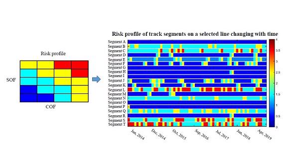

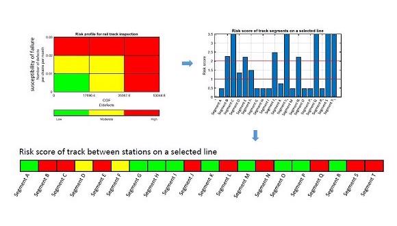

The Rail Track Risk Assessment Model, by TWI develops a risk profile for various track segments based on their susceptibility to failure and the consequence of failure (Figures 2 and 3).
The susceptibility of failure is determined using Artificial Intelligence (AI) techniques on data including defects data, annual load, traffic density, speed, etc.
The consequence of failure is determined by ‘Minimum Action Code’ (MAC) and can be customised to the end-user requirements.

Figure 2.
Figure 2.
Figure 3.
Figure 3.
