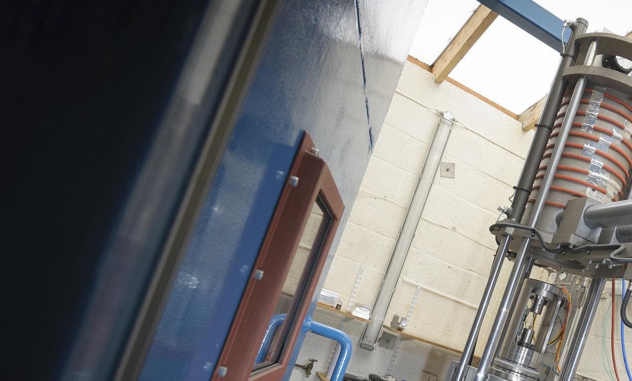

Tests followed the guidelines of ASTM E606 and allowed for the elastic-plastic cyclic response of materials to be characterised at pressures up to 450bar and temperatures between ambient and 80°C.
Bespoke grips were designed and manufactured to verify specimen alignment to ASTM E1012, thus minimising the risk of buckling and ensuring accurate and repeatable strains are applied to each specimen.
Tests were run in strain control using a Class 1 contact extensometer. A variety of waveforms, frequencies (i.e. strain rates) and stress-ratios can be applied at total strain ranges typically up to 2%.

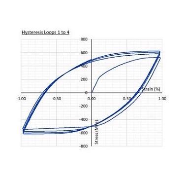

The hysteresis loops, Figure 1, provide information on the work hardening or softening behaviour of the material.

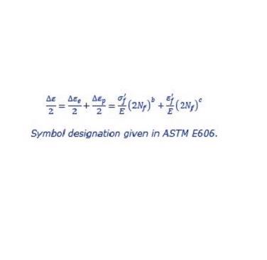

While the stabilised peak stresses and strains and the total number of cycles to failure data enable the Basquin-Manson-Coffin Strain-Life Equation constants to be determined (Figure 2).

Figure 1. Hysteresis loops for cycles 1 to 4 showing work hardening behaviour
Figure 2. Basquin-Manson-Coffin Strain-Life Equation
