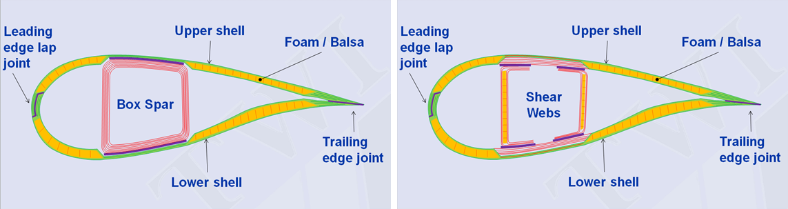

Blade structures differ between manufacturers. Many types have a main structural beam, either a box spar or shear web(s)(fig 1), enclosed by half-shells that transfer the aerodynamic load.
Control of the adhesive bond line (the purple lines  in Figure 1) for the first joint can be achieved during manufacture, as access is available when the beam is fitted into the lower shell. However, when the upper shell is positioned, any manufacturing tolerances need to be accommodated in the bond line. Sufficient adhesive is required to ensure that a good bond is made across the joint, filling the maximum possible gap between spar/shear web and shell, without having so much that it is pressed out of the joint and accumulates in the blade cavity, adding unnecessary weight and the associated cost of excess adhesive.

Figure 1 – generic box spar and shear web main structural beam, with laminate/sandwich shells
