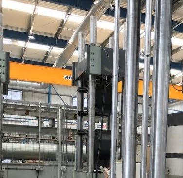

Figure 1. Monitoring changes in stress using electromagnetic transducers and phased array ultrasonic testing at different tensile loads.

  • Acquiring suitable material and then manufacturing specimens for acoustoelastic characterisation
  • Defining and producing a procedure for determining the acoustoelastic constant for each material
  • Establishing the ability and accuracy of each ultrasonic technique to measure known uniform and non-uniform stress fields in each material type
  • Measuring the effect of cyclic loading on RS in parent material containing a known RS distribution and welded material
  • Characterising the effect of initial RS magnitude, cyclic loading magnitude and stress-ratio on RS relaxation and fatigue life
