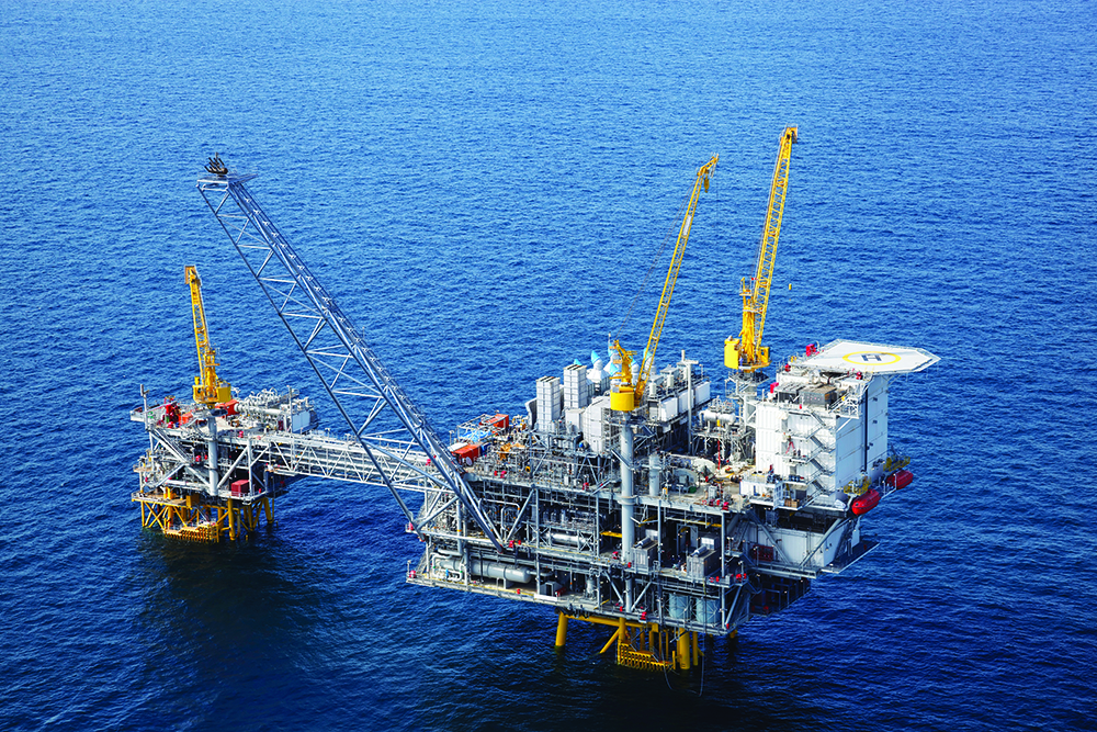

In oil and gas fields corrosion resistant alloys (CRAs) are often used in saline water injection systems due to their better corrosion resistance compared to low alloy steels. In high temperature applications, low alloy steels suffer from significant metal loss due to high corrosion rates, so CRA’s can offer considerable savings, especially if the cost of scavenging and de-aeration chemicals are added in.
