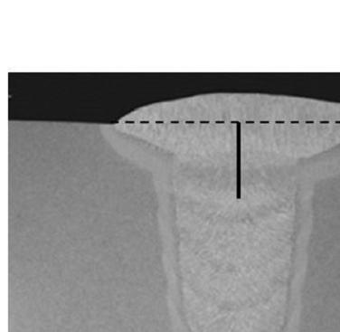

Figure 1. Notch position employed in the pipe test

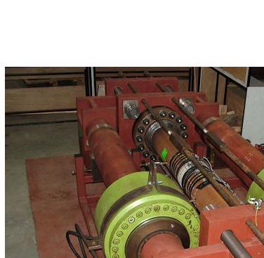

Figure 2. Pipe installed in tension machine

For the purposes of testing, the pipes were cut to a length of 2000mm.  The girth weld was located in the middle of the pipe length and the weld cap at the designated notch location was ground flush with the original pipe surface and etched to reveal the weld.  This procedure enabled the notch to be located along the weld centreline and also facilitated fitting of the knife edges close to the notch mouth, for subsequent instrumentation with clip gauges, as illustrated in Figure 1.

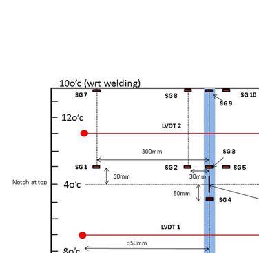

A single electrical discharge machining (EDM) notch was inserted at 4 o’clock in the pipe, which was subjected to tension only.  Figure 2 shows the installation of the pipe test in the tension machine.  Before this, the pipe was instrumented with strain gauges and linear variable differential transformers (LVDTs), as shown in Figure 3.

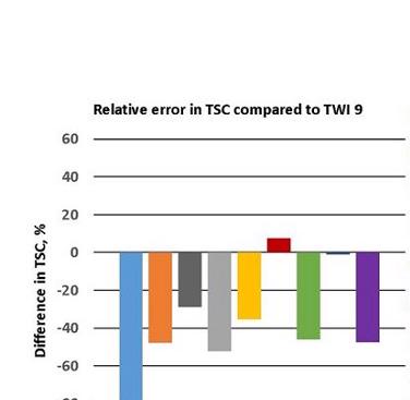

The strain capacity predicted using the methods in each group was compared with the large-scale test results.  Figure 4 shows that most of the existing methods are conservative compared with the test results.

In this study, the pipe sample was subjected to axial load only and attained a maximum load plateau at a strain of 5.07%; this was defined as its tensile strain capacity, and crack tip opening displacement (CTOD) of 4.03mm.  Most of the strain-based methods conservatively predicted the strain capacity for pipes under tension only.
Figure 3. Gauge plan for the pipe test
Figure 4. Comparison of strain capacity predicted using the existing strain-based methods with the large-scale pipe test result
