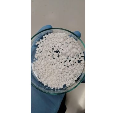

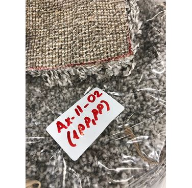

The ISOPREP Project aims to use solvents to recycle these complex products, with a particular focus on carpet feedstock, back into virgin quality polypropylene. This is to be achieved by exploiting a novel patented ionic solvent to selectively solubilise the polypropylene so that it can be reused elsewhere.
The ISOPREP method offers potentially several key advantages, both economically and environmentally. The method, which aims at is cost-effectiveness in comparison to fresh manufacture, will reduce the reliance of polypropylene production on fossil sources, thereby reducing emissions and energy use.
With the recycled products producing an identical performance to freshly manufactured resin, the recycling process is non-polluting due to the negligible loss of solvent per cycle. The solvent is non-toxic and non-flammable at the process temperature range, and able to remove dyes, colours and impurities.
