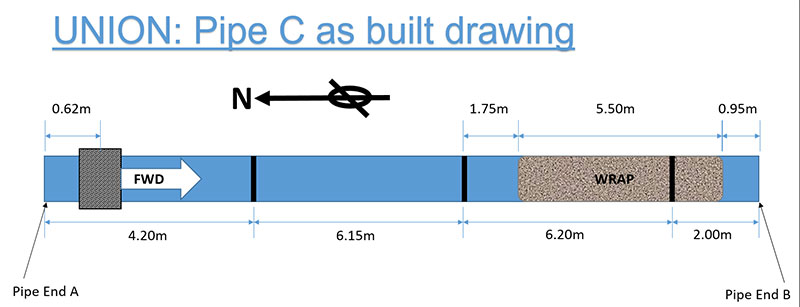

The challenge is for the guided wave instrumentation to be sensitive to the small signals, while not overloading the amplification stages with the comparatively very large signals from the low attenuation region, and causing the signals to clip.  Figure 1 shows test specimen: 8” schedule 40 steel pipe (219mm diameter, 8.18mm wall), partly coated with Denso tape to simulate the transition from an unburied to a buried section, which was used to illustrate this effect.

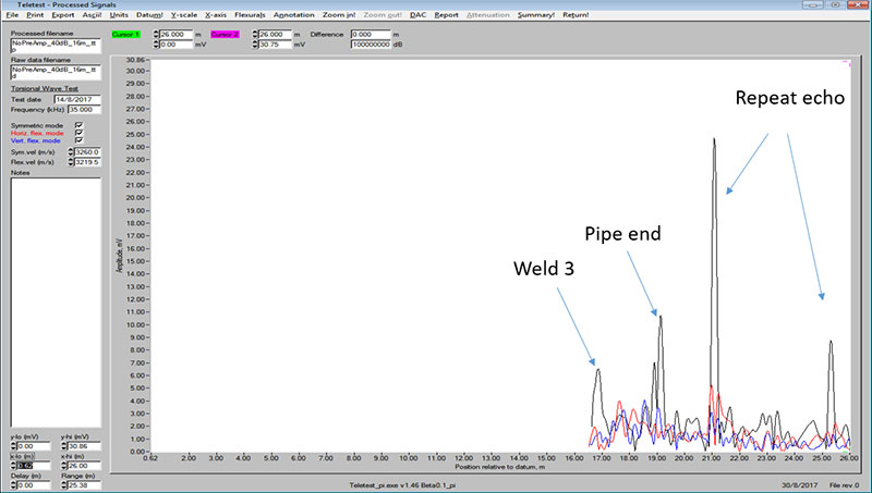

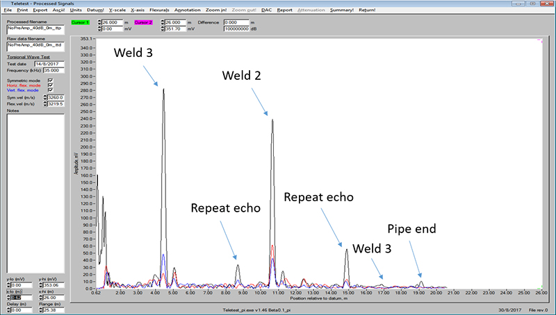

Figure 2 shows the effect of adding a delay to the start of the data collection to reduce the total dynamic range of the responses from features of the pipe.  Figure 2a shows the result when no delay was applied.  The responses from weld 3, which lies under the wrap, and pipe end B, are barely visible.  By introducing a 16m delay, the high amplitude welds in the uncoated part of the pipe can be removed and a much higher sensitivity may be used without the signals becoming clipped.

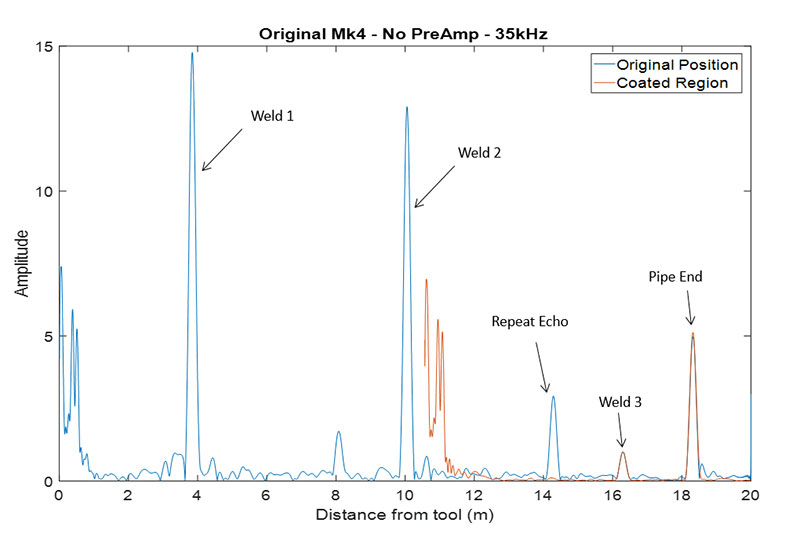

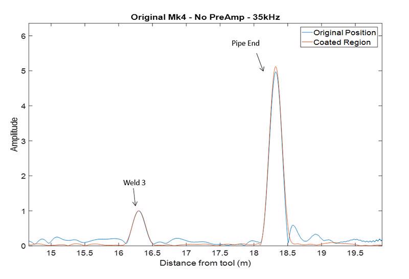

Further tests showed that by moving the transducer to 10.5m from end A, i.e., just before the start of the coating, the background noise level could be reduced.  The results are shown in Figure 3 giving at least a 6dB improvement in SNR around weld 3.  These signals are visible because a high gain is used to be able to observe the low amplitude response from the coated region.  When the transducer is moved closer to the start of the coating, there is less chance for long path length signals from the uncoated region to be present in the data, so the background signals observed in the coated part are reduced.

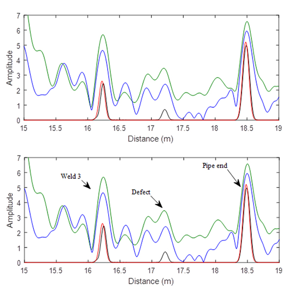

Since the velocity of DWM is a function of frequency, dispersive components of such signals vary across the SSP sub-bands whereas the non-dispersive ones stay constant.  Hence, use of the SSP technique would suppress regions of the signal that vary across the bandwidth, reducing the effect of DWM, which is one of the main sources of the coherent noise.  Therefore, the SSP method developed in this work enables virtually all the coherent noise on the baseline of the traces to be removed. Figure 4 shows the results before and after a 9% cross-sectional area slot defect had been cut in the pipe, midway between weld 3 and pipe end B.
The green trace in Figure 4a is the unprocessed data with a continuum of background signals after the introduction of the defect.  The red trace shows the processed result.  The real reflectors are preserved and the background signals are removed.  The response from the defect is clearly visible.  Figure 4b shows a zoomed plot of the defect region; several traces are plotted.  The blue line is the unprocessed result without the defect.  The green trace is the unprocessed result with the defect present.  The post-processed results in Figure 4b are for the cases without the defect (red) and with the defect (black).  The presence of the defect response at 17.2m may be clearly seen.  The amplitude of the black response is 12dB down on the response from weld 3, which is in line with the expected response amplitudes from a weld and a defect of this size.

Figure 1. Partly wrapped pipe: welds are shown as black lines and the tool location is 0.62m from end A
Figure 2. Teletest responses from pipe C in Figure 1; a) with no delay applied
b) with a 16m delay
b) with a 16m delay
Figure 3. Effect of moving the Teletest unit close to the start of the coating; a) Full length trace
b) Zoomed plot of the weld 3 region
Figure 4. Results of post processing on the detection of a 9% CSA defect. a) Full length trace showing unprocessed data (green) and the processed result (red). b) Zoomed plot of the defect region showing unprocessed data without defect (blue) and with the defect (green). Processed data are shown without defect (red) and with defect (black).
