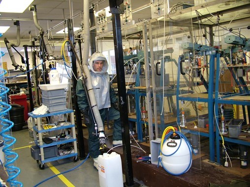

Figure 1. Special PPE worn by the technical staff

Due to the corrosivity and toxicity of the HF-containing test solution, additional precautions were made. All relevant staff and personnel undertook a special training course on safe handling of HF. Special PPE was worn by technical staff (Figure 1), emergency protocols established and a dedicated shower was installed prior to the start of the project.

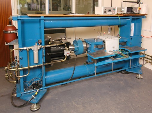

Fatigue endurance tests were conducted in both air and the HF-containing environment to produce S-N curves.  A test machine equipped with a polyvinylidene fluoride (PVDF) vessel for the environmental tests is shown in Figure 2. Comparison of the fatigue lives in both environments resulted in an EKDF, which was vital for the fatigue design of pipelines subjected to these acidizing environments.

Figure 2. A 600kN fatigue endurance test machine equipped with a PVDF environmental chamber
