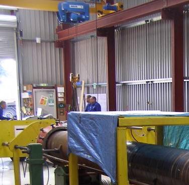

TWI regularly conducts full-scale fatigue testing of girth-welded pipe from steel catenary risers (SCRs) and pipelines for its Members, to ensure the welds have sufficient fatigue strength. These tests are typically achieved by resonance fatigue testing under constant-amplitude (CA) loading (Figure 1). However, these components are subject to VA loading in service, with a loading spectrum typically characterised by very high numbers of low stress cycles due to vortex-induced vibration (VIV). The choice of method for accounting for the fatigue damage due to stresses below the constant-amplitude fatigue limit (CAFL) can have a significant impact on the estimated fatigue life.

Figure 1. Resonance fatigue testing of full-scale girth-welded pipes

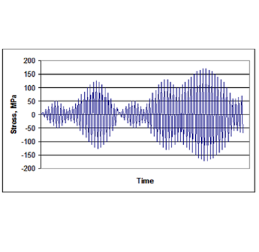

Controlling the resolutions of the motor using programmed software allowed precise control over the variation of the stress amplitudes. An example of stress–time signal achieved in full-scale VA test trials is shown in Figure 2.

Figure 2. Example of stress–time signal achieved in full-scale VA test trials
