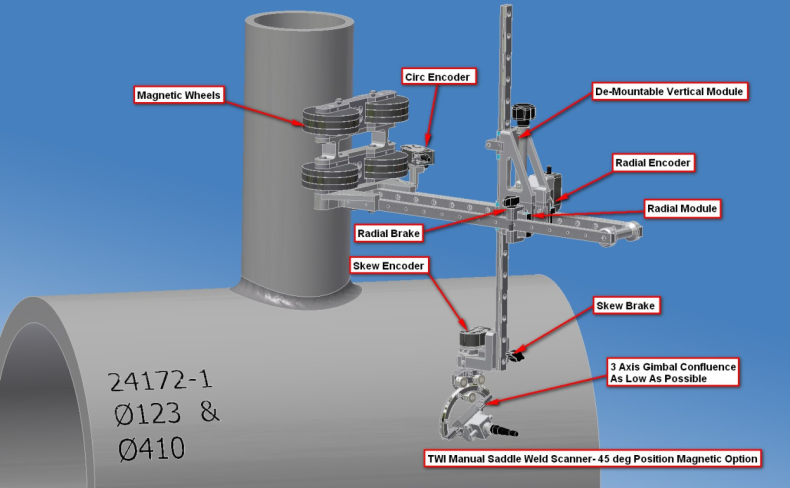

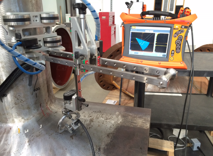

The first company TWI approached was Olympus NDT, which had already developed a prototype system that optically established the position and orientation of the phased array ultrasonic probe and plotted the inspection data from within the nozzle joint in real-time for operator assessment. TWI also worked with Phoenix ISL, to develop a unique three-axis manually encoded scanner for use by operators in the field. The scanning system was able to record the position and skew orientation of the phased array probe mechanically – information which was then used by a new module developed by M2M for its portable Gekko instrument to plot the inspection data in a 3D volume of the component for interpretation by the operator while in the field.

Fig 1. Phoenix ISL scanner on a test specimen and M2M Gekko instrument displaying data from within the nozzle joint

Fig 2. Design of three-axis manual encoded scanner for nozzles
