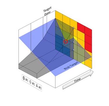

Risk increases with time without inspection

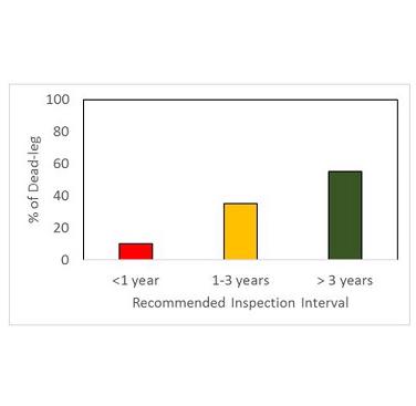

The project found that, while most of the dead-legs were medium or low risk, there were some that were in danger of failure and would need re-inspection within 12 months. Most of the dead-legs that were identified were small bore pipes with a diameter of under 3” NPS.
Based on the findings it was recommended that high-risk dead-legs should be removed or, if that was not immediately possible, they should be re-inspected within 1 year. Those dead-legs determined to be medium risk should be inspected again within 1 to 3 years, while low risk dead-legs wouldn’t need inspecting until 3 years had passed.
Finally, it was determined that any inspection results should be used to update the dead-leg register with details of corrosion remaining life and risk assessments should be repeated for each dead-leg.
Summary of recommended inspection interval of dead-legs based on risk category
