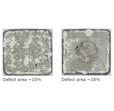

The TSA coating polarised the specimens below the potential of carbon steel. The defect areas in all the specimens were protected by the TSA ( two examples in Figure 1).

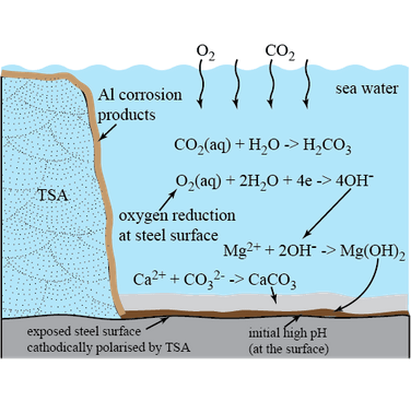

The defect regions were covered by a calcareous matter (Figure 1).  The formation of calcareous matter is beneficial, especially when the coatings are damaged in seawater immersion service.  These deposits comprise an inner layer of Brucite [(Mg(OH)2] and an outer layer of Aragonite (CaCO3).  In the current project, this deposit reduced the exposed steel area and lowered the corrosion rate of TSA.  The mechanism of formation of the calcareous deposits is shown in Figure 2.
The deposition of CaCO3 and Mg(OH)2 (from seawater) on a cathodically protected surface occurs as a consequence of increased pH near the metal-electrode interface (holiday/defect in our experiments). The formation of calcareous matter is an added benefit offered by these anodic coatings. However, these calcareous deposits only form in seawater, or in simulated seawater containing the minerals commonly found in seawater. Thus, the use of 3.5wt% NaCl solution to test these coatings to simulate marine environments is likely to give misleading data.

Figure 1. Photographs of specimens after 420 days of testing in ASTM D1141 synthetic seawater

Figure 2. Schematic showing the mechanism of deposit formation in TSA-coated steel containing defect
