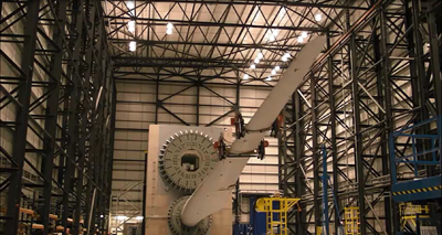

The main purpose of this study was to investigate the feasibility of in-service monitoring of the structural health of blades using AE. The experiment was developed at the National Renewable Energy Centre (Narec) 100m Blade Test Facility. A 45.7 metre long blade, in which a crack had been initiated, was subject to fatigue loads at different load values using compact resonant masses (CRMs) to excite the blade, accurately simulating in-service load conditions over a six-week period, during which AE monitoring was performed with four sensors.

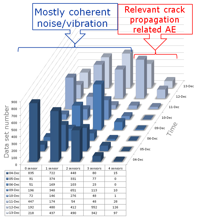

Over the course of the experiment over 9000 datasets were recorded. The challenge was to separate the signals caused by an AE event due to crack propagation, from those caused by the vibration and ‘coherent’ noise generated by the movement and friction of the blade.

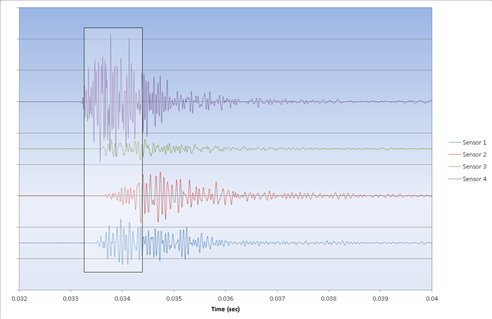

An AE event was defined as one where all four sensors were hit within a time span ranging from 100 to 550 microseconds. Eliminating those datasets where only 1-3 of the sensors were triggered, left 277 datasets with four signals crossing the threshold at least once. These were selected for additional analysis to confirm if they referred to an AE event.

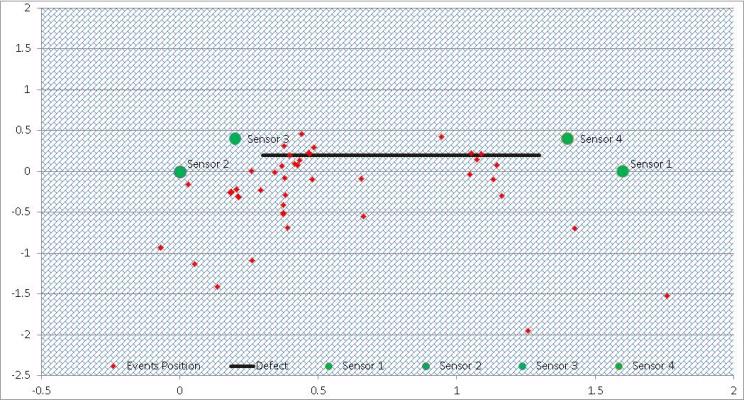

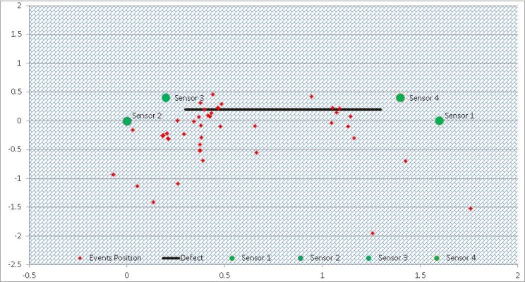

As AE signals propagate within the material at a specific speed, this value can be used to determine the defect localisation co-ordinates.  To determine the location of the event, the relative differences in time of arrival were calculated using the sensor that detected the first threshold crossing (45dBAE) as a reference point. The localisation process was then performed using trilateration method, finally obtaining the source localisation for four sensors being triggered by the AE. Clustered event locations can be confidently interpreted as representing crack propagation.
Testing a 45.7m long turbine blade.
Signals reaching 1, 2, 3 and 4 sensors
AE signals reaching the four-sensor array at different times
AE event locations
AE event locations
