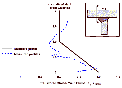

The use of these analytical and experimental techniques has led to a greater knowledge and understanding of the effect of component geometry, restraint, welding procedure, thermal properties, mechanical properties, phase changes and transformation plasticity on the magnitudes and distributions of residual stresses in welded joints [20] . This knowledge has led to more accurate analysis of the role of residual stresses in failure mechanisms, to the development of techniques for reducing residual stresses in sensitive locations, and to the preparation of standardised residual stress profiles for use in assessing the acceptability of defects in welded structures [21-23] .
Figure 10 shows a standardised profile for a T butt weld, which is conservatively defined relative to actual residual stress measurements.
Fig.10 Through-wall distribution of transverse residual stress at toe of T-butt weld
