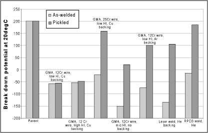

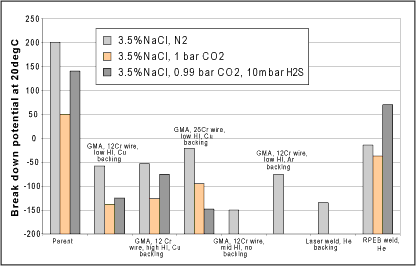

The root side pitting corrosion resistance of the welds, in the as-welded condition only showed fairly small variations and results were within a range of 140mV at most for each individual solution. The use of superduplex fillerwire gave a weld with a little higher pitting resistance than ones made with matching composition 12Cr6Ni2Mo wire. Pickling did not improve the pitting performance of the welds made with matching wire, whilst it did improve the pitting resistance of the weld made with superduplex wire, indicating that preferential pitting of the HAZ probably occurs in the as-welded condition but the matching composition weld metal limits pitting resistance when pickled.
Fig.4. Pitting potentials for a variety of SMSS welds in 3.5%NaCla) deoxygenated with
(i) N2,
(ii) CO 2 and
(iii) CO 2 with 10mbar H 2 S,
b) showing the effect of pickling (3.5%NaCl deoxygenated with N2)
For the SMSS wire, use of Ar root shielding gas or a copper backing bar was beneficial, due to reduction of the detrimental effect of oxidation. Laser welding, which had a helium trailing shroud but no inert gas root protection, gave lower pitting resistance than GMA welding but reduced pressure RPEB welding gave the best pitting resistance, as a result of the associated low level of oxidation, arising from production in a partial vacuum. The effect of oxide was emphasised by testing of pickled samples, which generally showed improved pitting resistance compared to the as-welded condition. No significant effect of heat input in GMA welds was noted over the range studied (0.55-0.97kJ/mm).It was noted that localised corrosion occurred at the weld toes in several cases, where small crevices/laps often form on welding Fig.5, and the oxidised HAZs.

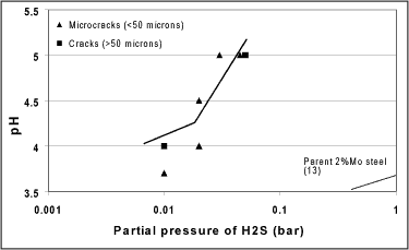

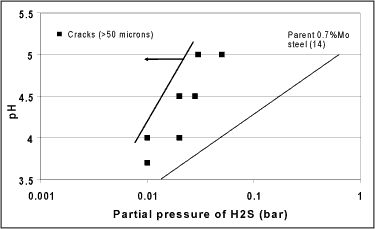

The results highlight the increased sensitivity of the weld region to SSC in a range of weldable martensitic stainless steel pipe materials Fig.6 to 9). Comparison with published data for parent steel [12,13] indicates a marked reduction, after welding, in the acceptable H 2 S level for SMSS. Highest resistance to SSC for as-welded joints was found in the steels with highest Ni and Mo content, even though these also tended to give higher HAZ hardness than the lower alloy grades.
Fig.6. Proposed SSC limits for as-welded 12Cr6Ni2Mo steel in 5%NaCl, 25°C
Fig.7. Proposed SSC limits for as-welded 11Cr1.5Ni steel in 5%NaCl, 25°C

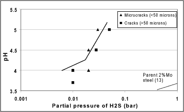

Fig.8. Proposed SSC limits in 5%NaCl, 25°C for welded 12Cr6Ni2Mo steel after PWHT at 650°C for five minutes

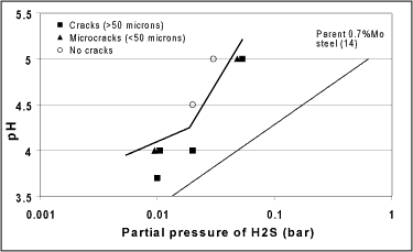

Fig.9. Proposed SSC limits in 5%NaCl, 25°C for welded 11Cr1.5Ni steel after PWHT at 650°C for five minutes
Definition of limits was complicated, in particular for the high grade steel, by the observations of very short 'microcracks', typically 50-150µm deep, in many of the specimens. The origin of these cracks was not clear. Examination of sections from the welds, which had not been exposed to a test environment, indicated that small weld toe flaws (typically <50µm in depth) may form on welding. The limiting conditions for SSC proposed here arebased on the assumption that any crack <50µm deep was a result of SSC. However, it may be noted that for steel with 2-2.5%Mo and 6-6.5%Ni, cracking to a depth of >0.5mm was only observed in this test series after exposure ata pH of 3.2, with 0.016 bar H 2 S, so the proposed limits may be conservative.
