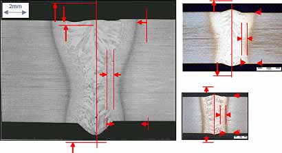

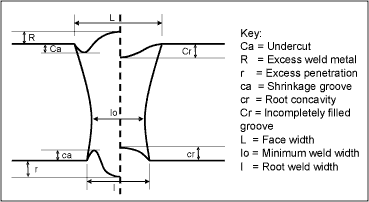

Figure 1 depicts the weld profile terminology used in Table 1.
Fig.1. Schematic indicating the weld geometry terminology used

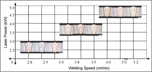

A series of bead on plate runs were made between powers of 2.9kW and 4.8kW at speeds which produced fully penetrating 'silver' coloured welds, with no surface breaking porosity. Selected representative cross sections of these welds can be seen in Figure 2, superimposed on a graph of laser power against welding speed. As can be seen, the profiles of these welds are quite similar, notwithstanding the range of power and speed used, with the welds made at the lowest laser power showing the narrowest minimum weld width, Io. The heat input range for the welds shown in Figure 2 was from 0.062kJ/mm to 0.054kJ/mm.
Fig.2. 3mm cross-sections arranged by laser power (kW) vs welding speed (m/min)

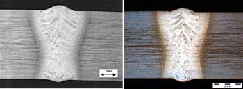

Not all of the welds shown in Figure 3 were sectioned and assessed against the weld geometry criteria shown in Table 1. However, at least 6 of the bead on plate runs met all of the weld profile criteria. For the butt welds, both extremes of welding speed used again produced weld profiles meeting all of the geometric criteria listed in Table 1. Figure 4 shows cross sections of both the bead on plate run and the butt weld, made at 4.8kW of power, at a speed of 5.2m/min. Both these welds met the porosity and geometry criteria listed in Table 1. It is also interesting to note that there were only very small differences in geometry between these two sections.
Fig.4. Bead on plate (left) and butt (right welds made at 4.8kW and 5.2m/min in the 3mm thick material

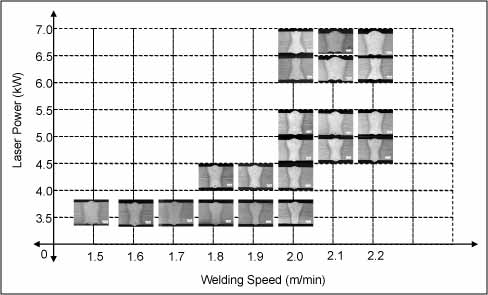

A similar approach was taken for the 5mm thick titanium. In this series of experiments, laser powers between 3.8kW and 6.7kW, covering a speed range from 1.5 to 2.2m/min, were used to produce a series of bead on plate runs. The gas flow rates in the shielding system were changed slightly from those used for the 3mm material, but its configuration remained the same and the results reported below were all made at the same gas flow rates. Selected representative cross sections of these welds can be seen in Figure 5, superimposed on a graph of laser power against welding speed. An analysis of these weld profiles shows some interesting effects at laser powers above 6kW, where it has been possible to produce welds with smaller faceweld widths than root weld widths. For certain sets of parameters, these weld profiles also transferred to butt welds. All these fully penetrating bead on plate runs showed smooth, bright, top and underbeads, free from oxidation and surface breaking porosity. Figure 6 shows the porosity count for these bead on plate runs and a series of butt welds.
Fig.5. 5mm cross-sections arranged by laser power (kW) vs welding speed (m/min)

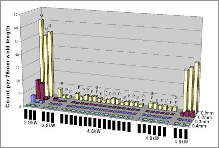

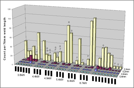

Fig.6. Porosity count for 5mm thickness Ti-6Al-4V
The first six groups of data in Figure 6 show (from left to right), bead on plate runs at 3.8kW and speeds from 1.5 to 2.0m/min, bead on plate runs at 4.4kW and speeds from 1.8 to 2.0m/min, bead on plate runs at 4.9kW at speeds from 2.0 to 2.2m/min, bead on plate runs at 5.4kW at speeds of 2.0 to 2.2m/min, bead on plate runs at 6.4kW at speeds from 2.0 to 2.2m/min and bead on plate runs at 6.7kW at speeds from 2.0 to 2.2m/min. It is clear that there is more small scale porosity in the welds made on 5mm thick material than seen in the welds made using 3mm thick material, and no clear trend as to how the power/speed combination affects the porosity is apparent. In fact, nine of these bead on plate welds met the acceptance criteria for cumulative length of porosity stated in Table 1 (limit 2.7mm) and these are indicated with a P in Fig 6.
Regarding weld profile, seven of the bead on plate runs met the weld geometry criteria for 5mm thick material shown in Table 1, and these are indicated with a G. All of these were at powers of 4.4kW and above. Only five of the bead on plate runs, (all made at either 4.4 or 4.9kW) met both the porosity and weld profile criteria. It is interesting to note that the two bead on plate runs made at 6.4kW, which met the porosity criteria, only failed the geometrical criteria in that the face weld width was wider than the root weld width.

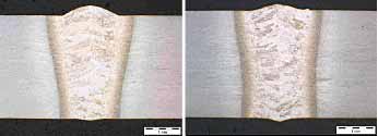

Due to the lack of clear direction from the bead on plate trials, it was decided to make butt welds at four combinations of laser power and travel speed in the 5mm thick material. The results of the pore counting exercise for the butt welds can be found in the last group of eight sets of data presented in Figure 6. From left to right the conditions were, 3.8kW/1.7m/min, 2 off - 4.4kW/1.9m/min, 2 off - 4.9kW/2.1m/min and 3 off - 6.7kW/2.0m/min. In all these butt welds, no porosity greater than 0.3mm in diameter was seen but only the three welds made at the highest power (6.7kW) met the criteria for accumulated length of porosity, of 2.7mm. In addition, only one of the butt welds produced could meet all of the weld geometry criteria. The three welds meeting the porosity criteria failed the geometry criteria in that the face weld width was smaller than the root weld width. Figure 7 shows the similar cross sections of both a bead on plate run and a butt weld made at 4.4kW of power, at a speed of 1.9m/min, for the 5mm thick material.
Fig.7. Bead on plate (left) and butt (right) welds made at 4.4kW and 1.9m/min in the 5mm thick material

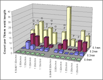

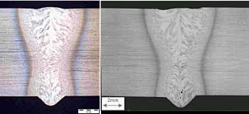

In order to penetrate the 9.3mm thick material, only two laser powers of 6.5 and 6.7kW were used to establish bead on plate welding conditions, at speeds from 0.95 to 1.1m/min. The left hand group of results in Figure 8 shows the porosity counts for the six bead on plate conditions used. Once again it should be noted that no porosity greater than 0.3mm in diameter was detected in any of the welds, but in the 9.3mm thick material,larger amounts of 0.2mm and 0.3mm porosity were observed. It is also worth noting that in the 9.3mm thick material, the number of pores of the order of 0.1mm in size, was generally less than for the 5mm thick material. Four of the bead on plate runs (marked with a P in Figure 8) passed the criteria for accumulated length of porosity. However, all the bead on plate welds which fully penetrated the material, managed to meet the weld profile criteria stated in Table 1.
Fig.8. Porosity count for 9.3mm Ti-6Al-4V
Based on the results of the bead on plate trials, five butt welds were produced, all at the highest laser power available of 6.7kW and at speeds of 0.90m/min, (2 off) 1.0m/min and (2 off) 1.05m/min (in order to obtain some idea of reproducibility). A single butt weld was also made at 6.5kW, with a speed of 1.0m/min. The porosity assessment for these welds can be seen in the grouping in the right hand side of Figure 8. The welds made at a power of 6.7kW and a welding speed of 1.0m/min, had very low porosity, in fact easily meeting the criteria for accumulated length stated in Table 1, but both of these welds failed the weld geometry criteria, with Io being too small. One of the other butt welds made at 6.7kW and a welding speed of 1.05m/min, failed both the weld geometry criteria (Io) and the porosity criteria. The remaining butt weld made at 6.7kW and 1.05m/min passed the sub-surface porosity criteria, but failed the weld geometry criteria (Io). The single weld made at 6.5kW met the weld geometry criteria and the sub-surface porosity criteria (although it contained significantly more porosity than the welds made at a power of 6.7kW and welding speed of 1.0m/min). Figure 9 shows cross sections of both a bead on plate weld and a butt weld made at 6.7kW of power, at a speed of 1.0m/min, for the 9.3mm thick material.
Fig.9. Bead on plate (left) and butt (right) welds made at 6.7kW and 1.0m/min in the 9.3mm thick material

Fig.10. The geometric weld quality criteria outlined in Table 1 superimposed on weld macrosections for the three thicknesses of material used in this work. The images are in scale with respect to one another
