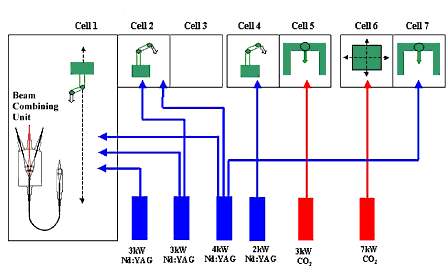

Another feature of the processing facility at TWI is the beam combining unit. This allows the three high power lamp pumped Nd:YAG lasers (10kW power in total) to be optically combined, transmitted via a 1.0mm diameter optical fibre to the workpiece, and re-focused to deliver 9kW at the workpiece. This has enabled TWI to investigate processing up to 9kW in advance of commercial systems becoming available and many projects have been carried out which investigated processing at these high powers.

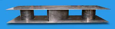

Welding of a complex geometry demonstrator component

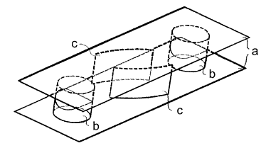

The first example discussed in this paper is a complex geometry structural demonstration component ( Figure 2). [7] It was the intention of this work to demonstrate that a robot mounted Nd:YAG laser was capable of producing fully penetrating, autogenous welds on a large, complex structural component with minimal clamping and jigging. The objectives were to demonstrate the feasibility of using robot mounted lasers for manufacture rather than produce a test piece for procedure qualification.
Fig.2. Schematic of 2200x700x300mm steel demonstration component a) cover plates b) tubes c) curved rectangular plates
The component comprised the following parts:
  • Two rectangular C-Mn steel plates of dimensions 2200x700x8mm thick. These were used as base and cover plate (a in Figure 2).
  • Two C-Mn steel tubes (b) of height 284mm, internal diameter 305mm, each with a wall thickness of 6.35mm. Each tube had been EDM wire cut into two pieces in a saddle joint configuration, and was to be welded back together around the 360° circumference of the tube. The cutting procedure provided a seam that varied from the normal position to up to 60° to the tube surface. Thus the required penetration over the circumference of the tube varied between 6.4 and 7.3mm.
  • Two laser cut, curved, rectangular C-Mn steel plates (c) of 445x284x12mm thick.
The welds to be made were of several types: butt welds in the PC (2G) position (saddle joints on tubes), T butt welds in the PB (2F) position (welding of tubes and curved plates to base plate) and stake welds in the PA (1G) position(welding through cover plate into tubes and curved plates). All welds were single-sided, except for the first of the curved plates, which was welded from both sides.
The welding head was mounted on a 6-axis Kawasaki Heavy Industries JS-30 floor mounted robot and 3kW of laser power was used for the butt and T butt welds. The stake welds through the cover plate were made by combining the output from the three separate lasers in the beam combining unit to achieve 8.9 kW at the workpiece. The parameters used to produce the welds are given in Table 1.

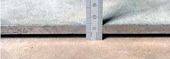

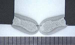

Fig.4. Cross section of saddle weld, showing high-low mismatch. Laser beam entry from the right. Scale in millimetres
Fig.5. Picture of finished 2200x700x300mm demonstration component
The work also highlighted some of the limitations of the use of lasers. The first was the very high accuracy required for positioning of the laser, particularly for butt joints. Also, so as not to impair the accessibility, clamping needed to be kept as close to the component as possible. Anything that sticks out increases the likelihood of a collision with the robot arm, or entanglement of the fibre. Similarly, the processing head should be kept as small as possible, which is particularly important for welding in corner areas. Modelling should be used to determine the best robot orientation and welding sequence. Although the fibre optic cable is flexible to some extent, it cannot be twisted or bent over too small a radius. It is generally preferable to pre-wind the fibre in such a manner that it unwinds during the welding sequence.

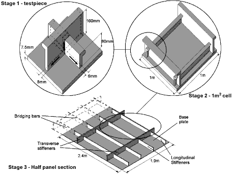

Welding of stiffened panels for shipbuilding

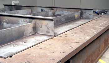

A further development was the manufacture of a stiffened panel demonstrator component typical of that used in the shipbuilding industry. [8] This was conceived to demonstrate the advantages of three dimensional laser processing using robot manipulated 4kW Nd:YAG lasers. Again, the focus was on the feasibility of producing large structural components using robot delivered Nd:YAG laser, rather than producing a fully qualified structure. The panel contained stiffener to stiffener and stiffener to baseplate joints. In addition the baseplate came in two halves that had to be butt welded together.Clamping and fixturing were basic, consisting primarily of plates, bars, and G-clamps to hold down the components during welding. A pneumatically operated bridging clamp was also used to ensure close fit-up of the stiffeners to the base plate during manufacture of the full size panel. However, attention was paid to producing welds which met geometrical tolerances and the structure was assessed in terms of the distortion produced. Initial parameter development preceded the fabrication of a 1mx1m test panel and the eventual production of a 4.8mx1.9m full size panel section. The material used during process development, and for the eventual construction of the stiffened panel conformed to BSEN 10025:1993 Grade 275JR. Three thicknesses of steel were used; the base plate (7.5mm thickness) and rolled bulb flats for the longitudinal and transverse stiffener components (8 and 6mm thickness respectively).

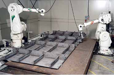

A diagram of half the component is shown in Figure 6. Again, the welding head was manipulated on floor mounted robots. The work was carried out in three stages:
  1. Initial parameter development using small T-joint test pieces.
  2. Production of 1m2 panels (equivalent to one 'cell' in the full size panel) for demonstration.
  3. Production of the full size 4.8m x 1.9m panel via two halves of 2.4m x 1.9m.
Fig.6. Testpieces used during procedure development (stages 1 and 2) prior to manufacture of full sized panel (stage 3)

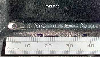

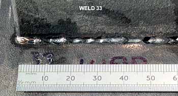

Initial parameter development had produced good results at welding speeds of 0.7 m/min giving acceptable profile and penetration. However, when the 1m 2 panels were produced, problems with fit up were encountered. At processing speeds of 0.7m.min the laser process was not able to cope with the gaps up to 1.0mm seen in the structure. De-focusing the laser by 3mmabove the plate surface solved this but at the expense of processing speed, which had to be reduced to 0.3m/min ( Figure 7).
Fig.7. Weld bead appearance for welds made with 1.0mm joint gap, 0.3m/min welding travel; speed Fig.7a) 0mm focus position;
Fig.7b) +3mm focus position

Each half of the panel followed an identical assembly route using the optimum parameters developed during the preceding trials. The stiffener sub-assembly was welded using a vertical up procedure and the curved bulb top sections of the longitudinal stiffeners were arc welded. The base plate and pre-welded/milled stiffener sub-assembly were clamped to a work bed. The stiffeners were tacked into position using laser welds ~40mm in length. Once all of the tack welds were complete, all of the stiffener-base plate joints were welded. Each internal cell was welded in one continuous movement of the robot with some overlap at the stop/start position. The two halves of the panel were then positioned and butt-welded in the PA position giving full penetration. Finally, the four sections of longitudinal stiffener were tacked then fully welded into place. On completion of welding, the panel showed minimal distortion. Figure 8 shows the completed panel.
Fig.8. Completed stiffened panel
Figure 9 shows the distortion of the part due to welding after the clamps were released. It can be seen that although the welding of the part resulted in some distortion, this was not excessive.
