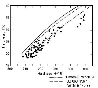

Welding procedures for hardenable 13%Cr steels are designed primarily to avoid hydrogen fabrication cracking and to obtain adequate weld area toughness [1] . This normally involves both preheat prior to welding and postweld heat treatment (PWHT). Given appropriate control of temperature at all stages, it is a fairly straightforward operation to obtain sound joints in plain 13%Cr alloys giving the desired mechanical properties. Particularly stringent attention is necessary with the higher carbon grades such as AISI 420, but welding can nevertheless be carried out reliably to meet appropriate specification requirements.

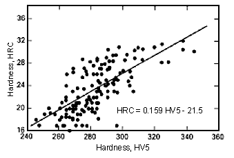

For sour service, NACE MR0175 specifies maximum hardness levels for base metals, and requires that welded joints should meet similar hardness limits. There has been very little attention to determining the SSC behaviour of weldments in 13%Cr steels, and some reduction in weld metal behaviour might be expected, recognising the inevitability of alloy element segregation during solidification and of a high inclusion population. Nonetheless, compliance with base metal hardness limits has normally yielded satisfactory service of welded joints. For martensitic stainless steels, a postweld tempering operation is necessary to obtain the requisite hardness levels. This poses no particular problems with plain 13%Cr alloys, but some difficulty is commonly experienced by fabricators with low carbon grades such as F6NM in achieving the prescribed hardness maximum [2] .
These alloys contain nickel to ensure hardenability which leads to a significant reduction in the Ac 1 temperature. Postweld heat treatment is therefore necessarily carried out at fairly low temperature, typically 580-620°C. While a three stage heat treatment is stipulated for the base metals in MR0175, this is seldom applied to welded joints, although a two stage procedure is common to try to achieve the requisite degree of softening. The MR0175 standard utilises the Rockwell system to describe weld area hardness, but this is not appropriate for welded joints, because the width of the transformed heat affected zone (HAZ) may be similar or smaller in size than the Rockwell C indent, so that material adjacent to the HAZ is also sampled during the test. Weld area hardness should, therefore, be assessed using a system with a smaller indent such as the Vickers or Rockwell N methods. However, it must be appreciated that the hardness conversion tables for ferritic steels in, for example, ASTM E140 are not appropriate for low carbon 13%Cr steels. Work at TWI supported the Hayes-Patrick [3] relationship for these materials ( Fig.1), which indicates that the NACE limit of 23HRC is equivalent to 275HV and not to 255HV as indicated by ASTM E140. Recognition of this conversion will facilitate achievement of welded joints in low carbon 13%Cr steels meeting the intent of MR0175, without the necessity for prolonged heat treatment at low temperature, and utilisation of very low carbon contents, both of which can lead to tensile properties being below specification minima after the heat treatment is completed.
Fig.1. Comparison of Rockwell and Vickers hardness for 13%Cr/4%Ni base steel and weld metal [2,3]

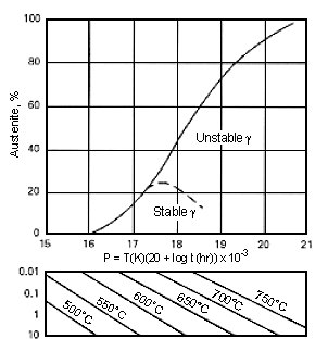

At present, the environmental limits of application of the new 13%Cr steels have not been fully explored. The cheaper, more ferritic alloys have found limited use for mild media, and have been considered for sour service in view of their low HAZ hardenability, but attention has tended to concentrate on the more hardenable variants. Studies have shown that the mechanical properties of welded joints in these steels in the as-welded condition are very attractive [4,5,9] . However, the inevitable HAZ hardening means that a PWHT cycle is required to achieve tempering and meet NACE MR0175 hardness requirements. As with F6NM, it can be difficult to achieve the necessary softening, given the conflicting requirements between increasing the temperature to obtain rapid tempering yet avoiding reaustenisation. Some success has been demonstrated using short term thermal cycles at around 650°C, as might be applied for laybarge applications, but time and peak temperature must be carefully controlled, as illustrated by Fig.3. Further, the high alloy variants display appreciable solid solution hardening and resistance to softening on short term PWHT [10] , so that compliance with a 23HRC maximum is extremely problematic ( Table 2). At the same time, the steels may have adequate SSC resistance for satisfactory service to be obtained at above this hardness level; appropriate testing is necessary to clarify the situation, and this will entail careful consideration of the test environment to be employed [11] .
Fig.3. Effect of tempering conditions on austenite reformation in 13%Cr/4%Ni steel [7]

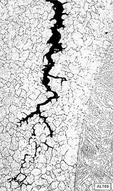

Notwithstanding the excellent mechanical properties that have been achieved, it must be appreciated that many envisaged application areas for low carbon 13%Cr steels will entail placing in service an as-welded martensitic HAZ structure. This has not been common practice for martensitic stainless steels in the past, PWHT being normal to obtain weld area tempering and softening. There is the possibility that HAZs may be sensitised to intercrystalline attack on welding by precipitation of chromium-rich carbides on the prior austenite grain boundaries, with no healing by chromium diffusion during subsequent PWHT. Intergranular cracking of as-welded joints has been observed [10] in laboratory tests under sweet conditions, at least with lower alloy variants ( Fig.4). This potential problem is in fact recognised in industries other than oil and gas, from which experience suggests that practical failures arise only under specific environmental conditions, probably corresponding to a redox potential close to the matrix active/passive transition so that only sensitised grain boundaries are corroded. Such sensitisation may further require an 'additive' effect of multiple weld thermal cycles, since failures have been manifest principally at multipass welds or at weld junctions where the material undergoes local repeated heating into the sensitising temperature range. It is not clear how far sensitisation will constitute a practical hazard with as-welded low carbon martensitic 13%Cr steels in the oil and gas sector, and further work in this area is necessary.
Fig.4. Intergranular cracking in the HAZ of a multipass weld in 11%Cr/1.5%Ni steel, tested as-welded in a sweet brine at 120°C [10]
Study is required also on the susceptibility of the transformed HAZ structure at a weld to hydrogen-induced environmental cracking. To date, the assumption has been made that compliance with NACE hardness limits is sufficient to ensure satisfactory service, but this must be confirmed in different media, with attention also to the possible adverse effect of hydrogen pick-up on external surfaces of subsea pipes from cathodic polarisation.

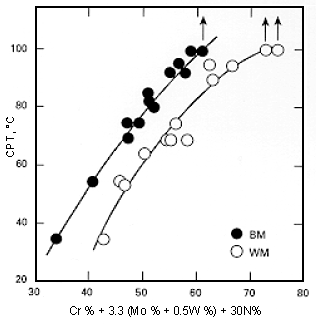

When high alloy stainless steels are welded, the main corrosion concern is the fact that segregation of alloying elements inevitably takes place during solidification of the weld metal [15] . This is especially the case for molybdenum, and the initially solidified dendrite cores can be significantly depleted in this element relative to the inter-dendritic regions which are last to solidify. Chromium will segregate in a similar sense to molybdenum, although to a lesser degree, and the result is that the corrosion resistance of the solidified weld metal will be determined by the dendrite centres which are depleted in elements primarily responsible for corrosion resistance. In consequence, the corrosion resistance of nominally matching weld metal is inferior to that of the surrounding base steel ( Fig.5) [15,16] . The effect is most marked in high molybdenum grades, and, with low molybdenum alloys such as R20033, matching composition weld metal can give corrosion properties more akin to those of the parent material [17] .
Fig.5. Effect of composition and weld metal segregation on critical pitting temperature in ferric chloride tests on high alloy materials [16]

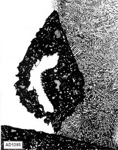

Welding the superaustenitic steels, especially with nickel-alloy fillers that may have a melting point somewhat below that of the base metal, can lead to a small region of base metal at the fusion boundary that is melted but not incorporated into the bulk deposit. This unmixed zone (UMZ) is in effect an autogenous weld with inevitable segregation of molybdenum and, if present at the weld surface, will reduce corrosion resistance ( Fig.7). Debate exists regarding the conditions causing such an unmixed zone [21,22] , and its practical significance, but available evidence indicates that it is most marked with the GTA process, and less severe with flux processes. Nitrogen loss from the UMZ is probably negligible, so that, even given the fact of segregation, the UMZ does not have the same detrimental effect as autogenous welding. Nevertheless, its possible formation must be recognised, and, even with overmatching fillers, some reduction in weldment performance compared to base metal must be expected. The practical significance of any such loss must be investigated by undertaking appropriate corrosion tests on welded joints made reproducing the procedure to be used in practice.
Fig.7. Pitting attack initiated at UMZ in GTA weld in S31254 steel made with ERNiCrMo-3 filler [21]

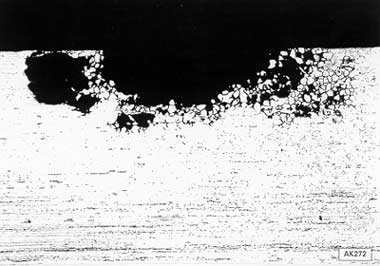

Like other high alloy stainless steels, the superaustenitic grades are potentially sensitive to intermetallic formation at around 600-1000°C, and intermetallic precipitation has been reported in the HAZs of welded joints [23] . In principle, this can reduce corrosion resistance by an alloy element depletion mechanism analogous to the problem of 'weld decay' from carbide formation in common 300 series materials. However, intermetallic phases have not so far been manifest as a significant service problem, probably because of two reasons. First, precipitation rate is reduced by the high nitrogen contents in the steels [24] . Second, it is normal good practice to weld superaustenitic materials using low arc energy and interpass temperature [19] , so that the time spent on cooling in the critical temperature range is not unduly protracted. Precipitation rate may be increased in high molybdenum alloys, and steel manufacturer's recommendations on maximum arc energy must be followed, as illustrated by the intergranular HAZ attack in a high heat input weld shown in Fig.8.
Fig.8. HAZ pitting in high heat input S23654 weld tested in FeCl 3 at 80°C

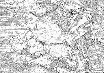

In contrast to the case with martensitic and austenitic steels, the microstructure developed at a fusion weld in duplex grades can differ very significantly from that in the base material [26] . The primary solidification phase is ferrite, and, given the fairly rapid cooling associated with a weld thermal cycle, diffusional transformation to austenite can be suppressed, leading to a predominantly ferritic structure in the fusion zone on cooling to room temperature. The HAZ is heated to temperatures close to the solidus, inducing transformation from the original two phase microstructure to ferrite, and again this is retained on cooling ( Fig.9).
Fig.9. HAZ microstructure of 22%Cr duplex steel arc weld

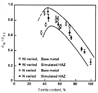

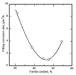

The properties of ferritic-austenitic steels are highly dependent on the phase balance. Pitting resistance is normally considered to be optimum when the ferrite and austenite are present in roughly equal proportions ( Fig.10) [27] ; high weld area ferrite levels have induced pitting in offshore service, and can significantly reduce resistance to sulphide stress cracking ( Fig.11) [28] , and possibly also chloride induced stress corrosion [29] . High ferrite levels have also caused failure in high pressure hydrogen applications [30] . In the weld metal, suppression of a ferritic structure is readily achieved by increasing the nickel content relative to base steel, and this practice is the norm for commercial welding consumables. Considering the HAZ, it has in the past been necessary to specify a minimum heat input to ensure that cooling is sufficiently slow for adequate austenite reformation to take place [26] . However, development has led to production materials with increased nitrogen content relative to earlier alloys (circa 0.15-0.16% as compared to 0.12-0.13%) and this has greatly improved the tolerance of the materials to welding with low heat input, although the very rapid cooling associated with power beam welding (laser, electron beam) must still be regarded with caution. In consequence of these changes, satisfactory ferrite-austenite balance can be consistently achieved for a range of welding procedures.
Fig.10. Effect of ferrite-austenite balance on pitting resistance of 22%Cr/0.12%N GTA weld metal in FeCl 3 solution at 50°C [27]
Fig.11. Effect of ferrite content on threshold stress from SSC tensile tests on 22%Cr duplex stainless steel; 5%NaCl/0.5%CH 3 COOH/0.1MPaH 2 S, 80°C [28]

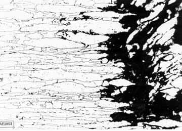

Formation of intermetallic phases on welding poses a greater problem with ferritic-austenitic steels than with the superaustenitic alloys. Such transformation is most marked with the superduplex materials because of both the high level of alloying and the rapid substitutional element diffusion permitted by the ferrite phase. There is therefore no doubt that a maximum arc energy and interpass temperature must be specified when welding ferritic-austenitic steels to avoid unacceptably slow cooling and extended times in the intermetallic formation temperature range [26] . Intermetallic phases reduce toughness and corrosion resistance ( Fig.12) in a range of media, and may also enhance any tendency for SSC ( Fig.13). The risk of forming intermetallics during welding is now well recognised, and limits on arc energy and interpass temperature are given in typical manufacturers' literature. However, particularly with the superduplex grades, the material must be in the optimum treatment condition prior to welding. In production of forged components etc involving reheating, it is possible for intermetallic nuclei to exist in the base steel if quenching from solution treatment temperatures is not correctly carried out. The properties of the base steel may meet specifications such as ASTM A923, but imposition of a weld thermal cycle can lead to rapid growth of the intermetallic nuclei and considerable reduction in properties [31] . This can be manifest only during weld procedure qualification and, in such cases, it can be very difficult to limit total heat input to the weld and maintain a reasonable level of productivity.
Fig.12. Pitting attack in ferric chloride associated with intermetallic formation in a superduplex stainless steel

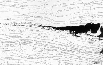

Fig.13. SSC in association with intermetallic precipitation in a ferritic-austenitic steel

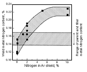

As with the superaustenitic steels, nitrogen loss can occur from gas-shielded ferritic-austenitic weld pools [32] . However, even with the trend to increased base metal nitrogen contents, this can be negated by fairly low additions of nitrogen to have gas shroud, say ca 2% ( Fig.14). Alternatively, the 22%Cr duplex grades can be welded, at least for most runs, using superduplex consumables to achieve overalloying, and this measure is fairly commonly employed to achieve high deposit corrosion resistance.
Fig.14. Effect of nitrogen level in Ar shielding gas on weld metal nitrogen content for 22%Cr duplex steel [32]

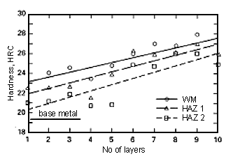

Nitrogen in stainless steels is an extremely potent solution hardening element, particularly in cold worked material. During welding, the material in the weld area undergoes constrained expansion and contraction, leading to increased dislocation density, and the resultant hardening in nitrogen-containing steels can be sufficiently marked that it is difficult to meet hardness limits as specified in NACE MR0175. This has been recognised with superduplex materials for some time, especially in multipass welds made with low heat input and small weld beads to avoid intermetallic formation, but with resultant repeated thermal cycling ( Fig.15) [33] . The situation is complicated by the fact that there is no standardised conversion system between Vickers and Rockwell measurement for ferritic-austenitic steels and direct application of, for example, ASTM E140 has led to considerable problems in qualifying procedures without exceeding 275HV taken as equivalent to 28HRC. As for the 13Cr/4Ni martensitic alloys, use of a ferritic steel correlation is not correct. Fig.16 was developed [34] specifically for ferritic-austenitic steels, and this would indicate that, if 28HRC is to be maintained for superduplex grades, weld area hardness of up to about 310HV should be taken as acceptable. Following the increasing nitrogen contents in 22%Cr grades to facilitate achievement of a satisfactory phase balance, a similar problem of weld area hardening has emerged for these lower alloy materials. At the same time, it must be realised that hardness levels in MR0175 were derived originally from studies of deliberately cold worked materials in severe downhole applications. They should not necessarily be directly applied to welded joints, and certainly there seems to be no reported SSC failure of welded ferritic-austenitic steel associated with the hardening which inevitably takes place in the weld area.
Fig.15. HAZ hardening at welds in superduplex stainless steel [33]
Fig.16. Comparison of Rockwell and Vickers hardness for ferritic-austenitic steels and weld metals [34]
