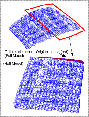

The structure illustrated in Figure 7 is part of the hull of a US Navy destroyer, fabricated by a US ship fabricator. This very large section incorporates numerous tee fillet welds, both vertical and horizontal. The key point illustrated here is the manpower effort required to perform this analysis. A solution to the distortion control of a panel such as this would mainly be sequencing. This analysis was performed quickly.
Three VFT TM experts (one from Battelle and two from Caterpillar) performed this analysis as a team, with direction from one other leader. From the time they received engineering drawings to the completion of an analysis took one week (not including computer time). The VFT TM graphical user interface (GUI) for shell models, developed since this analysis was performed three years ago, would reduce the required time. For the purposes of illustration, the following man-hours were required.
  • Two key persons worked on this project.
  • Number of welds modeled = 154.
  • Model generation: person 1, 8 hours and person 2, 24 hours.
  • Total shell elements 30,000.
  • Set up thermal analysis, person 1, 8 hours.
  • Set up stress analysis, person 2, 8 hours.
  • Computer running time (three days - depends on computer - SUN Workstation here). This would be much faster today on an Itanium chip machine.
  • Results analysis and summary: person 1, 16 hours and person 2, 20 hours.
  • Total human hours: person 1, 32 hours; person 2, 52 hours.
  • Modelling procedures: lump-pass modelling procedures.
Since the structure had single pass welds, a relatively simple shell model was used and only one demonstration analysis was performed. Typically, additional analyses using different sequences, pre-cambering, or other distortion control technique, would be required, but once the baseline model is built, setting up additional analyses using the VFT TM GUI is trivial.
An illustration of the distortion control procedures for typical ship-type fabrications are found in Figure 7. As shown in the diagram incorporated in Figure 7, they were joined using double sided welds where the weld was first finished along one side and then the other side was completed. After the predictions were made, predicted results were compared with service welded panels (qualitatively). The distortion predictions match qualitatively with those found after actual welding. The actual distortions were not measured precisely at the time but the 'bow' distortion was predicted to be about 50 mm. More importantly, it is clear that weld parameters (e.g. heat input, torch speed, material) strongly affect the final distortion.
Fig. 7. Ship hull weld model (size = 12 x 24 meter)
The 12 x 24 m hull assemblage of Figure 7 was modelled for illustration using a typical welding sequence applied to 6 mm plate.
The resulting distortions of the full structure illustrate the issues of concern, showing by comparison with the initial (un-deformed) shape that the hull assemblage bows up along the long length. An assemblage like that in Figure 7, for example, will require five to ten separate analyses with varying parameters before the optimum sequence for distortion control can be realized. Again, weld sequencing should be the preferred control method.
