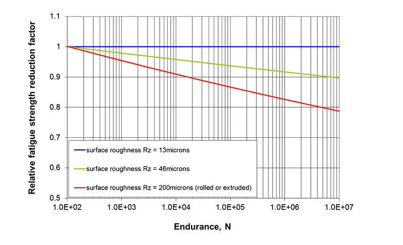

It has been generally recognised that, all other factors being equal, the fatigue performance of a component, from the point of view of failure from the surface, depends on its surface finish, the finer the surface finish the better the fatigue performance. Clearly, it would be useful to quantify this effect as well as that of applied stress ratio in the proposed new design approach. A possible method would be to adopt the surface finish correction procedure included in the European pressure vessel design rules, EN 13445 (20). This takes the form of a fatigue strength reduction factor, ƒs, that is applied to the design S‑N curve and is given by:
eq17 - Verification of Class B S-N Curve For Fatigue Design of Steel Forgings
[17]
where
eq18 - Verification of Class B S-N Curve For Fatigue Design of Steel Forgings
[18]
and Rz is the average of ten largest peak-to-valley heights (in μm) within the region assessed. To check the validity of the correction procedure, it can be applied to the present strip specimens. For these, the values of Rz were ~13μm for the strip specimens from Connector L and ~46μm for those from Connector H. By assuming that the roughness‑induced life reduction factor for the specimens from Connector L was unity, the relative life reduction factor for the specimens from the Connector H was calculated and the result is plotted in Figure 18. In the short life regime (100 cycles), roughness variation has no effect on endurance. The fatigue strengths of the specimens with rougher surface finish were predicted to decrease with increasing endurance, resulting in a fatigue strength reduction factor of about 0.9 at a fatigue endurance of 107 cycles. This indicates that, according to EN 13445, the surface finish effect on fatigue performance in this investigation is not expected to be significant, as indeed was the case. A wider variation in fatigue performance would be expected for a larger range of surface roughness. This is illustrated in Figure 18, which includes the correction recommended for as-rolled or extruded steel, the roughest surface referred to in EN 13445. Clearly, this surface finish correction could be used in conjunction with the proposed new design approach, taking a surface with around 10mm in Ra as the reference value.
It seems reasonable to assume that many of the structural components that provided the database in Figure 1 had surfaces that were comparable with as-rolled or extruded steel. As seen in Figure 18, the maximum fatigue strength reduction factor is now around 0.8. The basis of the correction in EN 13445 is not known. It may not be suitable for the range of surface finishes considered here, or there may be other features, such as distinct surface imperfections, in the lower fatigue strength structural components that over-ride any significance of the surface finish. This is an issue that requires further study.

Figure 18 Predicted relative fatigue strength reduction factor for the specimens with rougher surface finish (from Connector H) based on the guidance in BS EN 13445
Figure 18 Predicted relative fatigue strength reduction factor for the specimens with rougher surface finish (from Connector H) based on the guidance in BS EN 13445.
